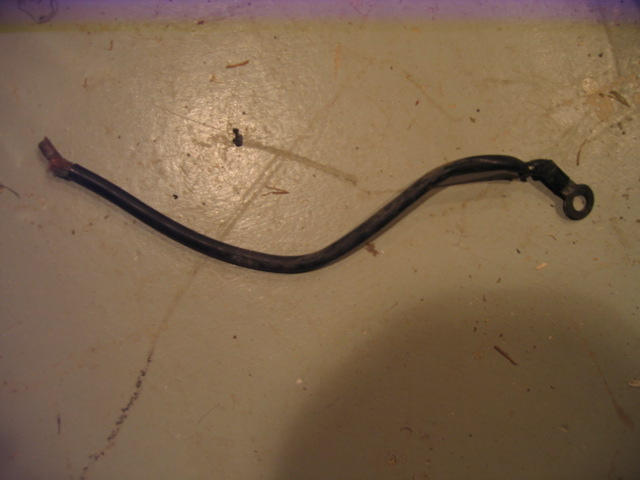

Apparently I lied in the previous post about the photo of the ground cable, but here it is. The battery connection end is broken off. My experience with a complicated vehicle of a certain British marque has caused me to be quite scornful of any large copper wires with visible green corrosion when said wire's purpose is associated with large electrical currents. The insulation at the other end of the wire is broken with corrosion apparent there too. I plan to visit an auto electrical shop to have a new cable made. Is there anything special about this cable that an OEM part should be purchased instead, or at least attempted to be purchased?

I'd make a new cable. ..............lm
