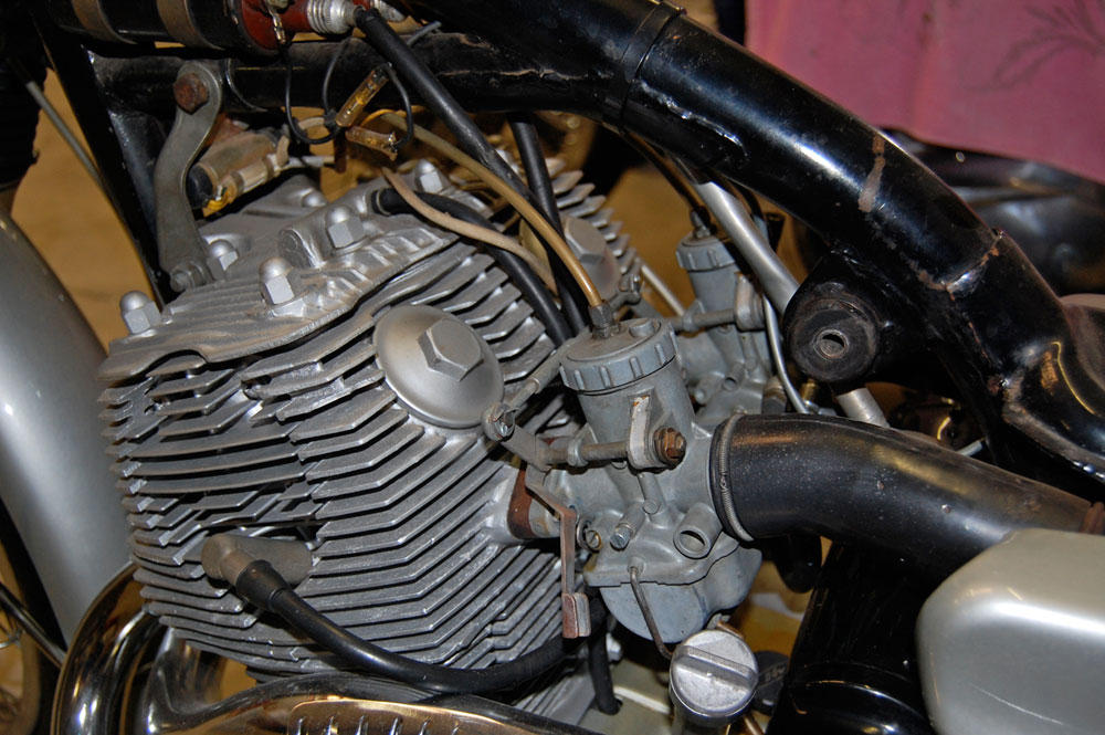

Re: carb/head photos

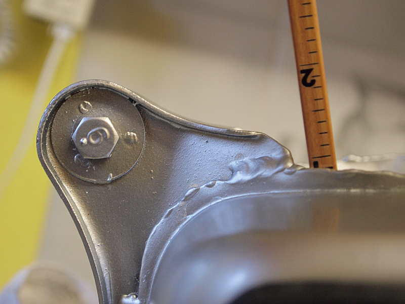

Well darn!
The rubbers do look correct for sure.
Any chance to have a look at the front mounts on the frame and the tank.
Also a pic of the top front with the tank mounted?. ...........lm

OK kids... Here's some photos of the tank and the frame rubber mounts. Doesn't look like anyone has messed around with the tank brackets. Can't tell for sure without another one to look at.
