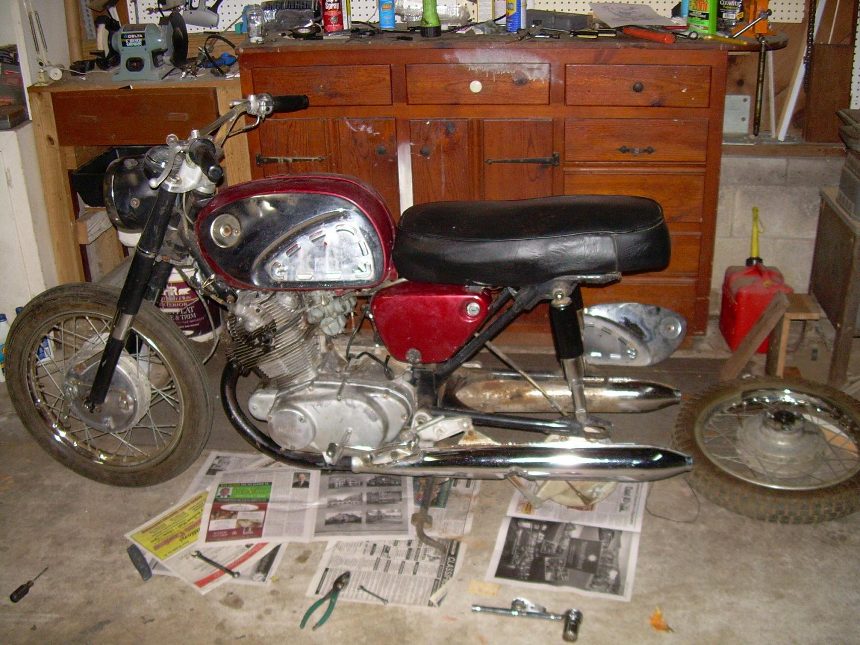

What a great forum. I wanted to update what is occurring with the cb77 I acquired. A lot of polishing. Electrical examination, carb rebuilding, starter rebuild and general greasing. I filled the bowls with fuel (tank not ready) and kick started the bike which ran beautifully for 3 minutes - hurray! Attached is a picture with the tank, seat and one side cover attached as a group for the first time tonight.

Brad, wow, that took all of what? Two weeks! I think you might have a keeper there. That's just a sign of how tough these old birds are.Suitable gas caps are still available from Honda, Retro-bikes has petcock rebuild kits & I'm sure someone around here has a side-cover. Welcome to the forum. Looks good............................D

Lookin' good, Brad. Looks like you've started about the same way I did. Looking back I can't believe all the different systems I went through and the time it took but man oh man is that bike fun to ride. I rarely take it on the highway but the thing just BEGS to get up in the rpms and the range of the power curve, which is where the good "song" resides too.

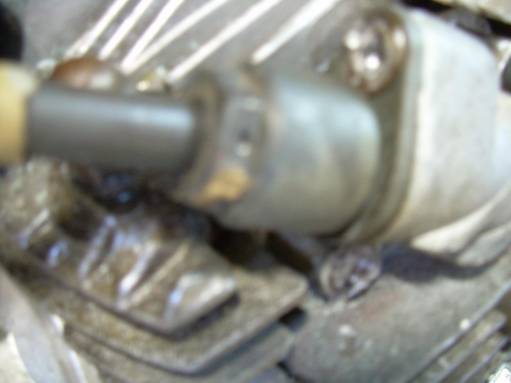

For now my issue is removing the screws from the tack cover and the left engine top cover. Its past the screw extractor tool possibility and may just grind the head down with a drimmel. There is always something and some days it goes smoothly and others well, you know.
