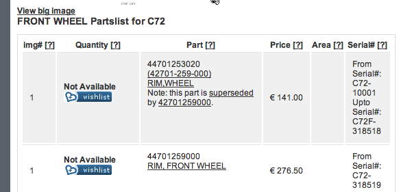

Graham, I beg to differ on the front and back rim part numbers bcoming one. Looking at the '64, '68 and '73 parts catalog, there are 4 "sets" of different part numbers for rims, each of which shows a different part number for the front and back.
The '64 catalog shows front rim C715401•1B which converts to 44701-253-020 and lists application for all years ('60 to '64 and includes CS model) then for '63 forward for CA72311561 CA77F-312958 it shows C725401•1 which converts to 44701-253-000. For the rear rim, the '64 catalog shows C716401•1B which converts to 42701-253-020 for all years ('60 to '64 and includes CS model) and then for '63 forward from the above frame numbers C726401•1 which converts to 42701-253-000.
The '68 catalog shows front rim 44701-253-020 and rear rim 42701-253-020 for '60 to '63 up to CA72311561 CA77F-312958 and then for all frame numbers beyond it shows 44701-259-000 front and 42701-259-000 rear.
The '73 catalog just shows 44701-259-000 front and 42701-259-000 rear with no distinction for any years.
Bill Silver's Dream NPS converter also shows C715401•1A/ 44701-253-010 front and C715401•1A/ 42701-253-010 rear, but I do not have anything that indicates the application.
Perhaps most important, because it spawned this thread in the first place - each of the changes in part numbers for rims has a corresponding change in spoke part numbers. Honda made some change in the spokes, though I have nothing that tells what it was. There were also changed numbers for hubs that change along with spoke/rim part number changes. That would imply that each set of hubs/rims takes a matching spoke set and that mixing and matching hubs and rims might create fitment issues. Also, aftermarket spokes might fit one hub/rim combination, but not necessarily another.
My purpose here is not to overthink re-lacing your wheels. At the end of the day, if you can get them back together and you are happy, that's probably all that matters. But, there has been no shortage of moaning and wailing on this site when it comes to fitting spokes, hubs and rims together. I hope the info in this post will help others get their wheels in ship shape. I plan to take on the task at some point and at least now I know more about what some of the challenges may be.
