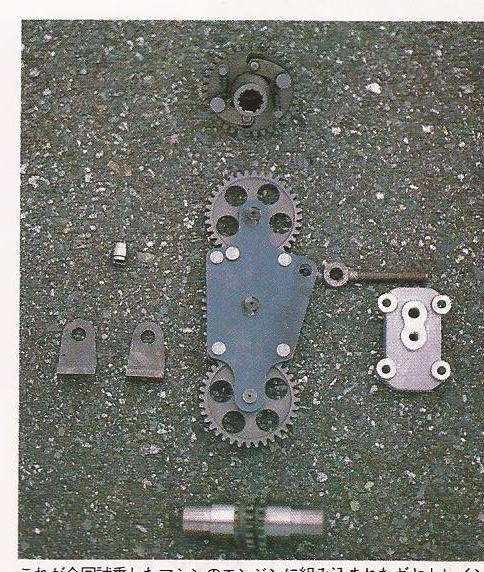

Jensey, I think it was George Flick's bike that had a extra lever on the L/H bar to engage gear, it was back in the old push start days and he just pushed the bike in neutral ( a lot less drag) then just "dropped" it into gear once moving, simple but clever !
The pictures below are,
1) The cam chain tensioner setup I had used, steel centre roller made by a friend and a toothed type tensioner ( CB450 or Kawasaki ? cant remember )
2) A gear drive setup from a article in Clubman magazine.
I think I should give the slipper idea another try as it looks a lot simpler than the above.
Back to the workshop then.
Gordon

Post by G-Man » Sun Nov 11, 2012 2:44 pm
Gordon
Thanks for posting those. The gear drive looks good. Are those oil pump gears top and bottom or specials?

Post by GORDON BROWN » Wed Nov 14, 2012 4:23 pm
Hello
G-Man, the gears are a conversion to replace the filter drive chain, it was supplied by Dennis Murfin / Peter Maddox who ran M&M racing. They also supplied the vernier cam sprocket in the picture along with the ASSO 350 pistons, O.S. valves and other parts.
Dennis still advertises in the VJMC magazine but I dont know what he still has available.
I dont know if the filter chains had given any problems but it does mean you can get the filter in and out easier.
