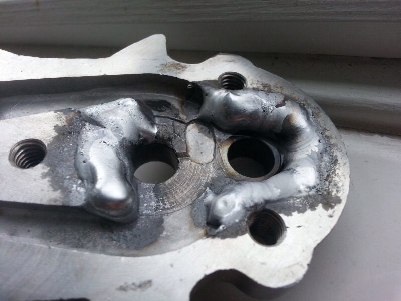

Has anyone tried TIG welding an aluminum alloy onto the oil pump scoring area and re-machining it to the original size? The only drawback I can come up with is possible warping, and possibly some bubbles inide the weld area. I had a CB77 lower case TIG welded where a screw had been tightened too much and had cracked the case, causing oil to leak. The results were great. My oil pump doesnt look too hot, and Im going to do something soon. Thoughts?

I don't see why that wouldn't work but you'd probably end up re-machining the whole cavity and joint face to get it perfect. My method opens up both the diameter and width of the pump cavity and uses corresponding larger gears which can be bought very cheaply.
Horses for courses. I don't have a TiG welding set but I do have small-scale machining facilities and a good gear supplier less than 20 miles away so my method was tailored to what I have.

Well I finally decided to TIG weld the oil pump. Fortunately I got good weld area penetration and no warping that I can tell. There was good fusion, and a little bit of parent metal melt back, so the machining should take place on fresh 4000 series aluminum. I realize it doesn't look very pretty in the photo, but the weld is strong, and as far as I can tell there are no bubbles in the weld puddle. It's pretty hard to weld on alumininum that is so smalll, and I was able to avoid damaging the steel shaft bushing and threaded areas of the casting. Anyway, I shipped it to a friend who is very excited about milling out the gear cavity and shaping everything up. I will let you guys know what I end up with. If this experiment goes wildly wrong hopefully I can get my hands on another pump!

Interesting to see the finished result. What welding equipment did you use?
Do you have undamaged gears to put in there?
