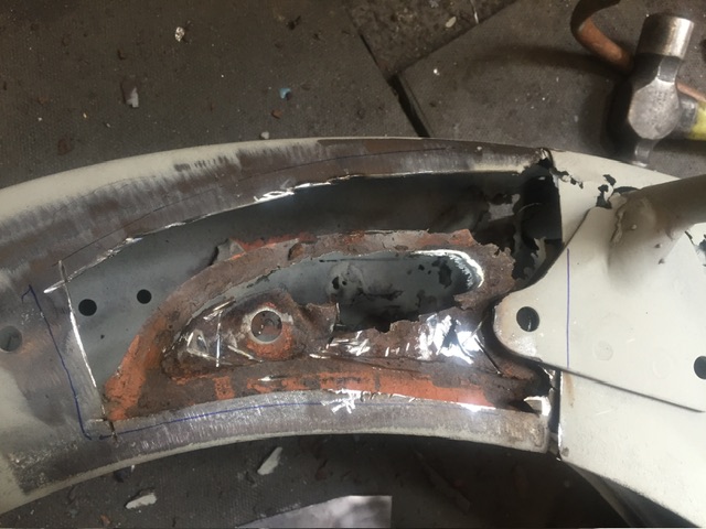

The rust on the frame is a real pain, I would get it shot blasted to show any other areas of concern, my C95 was really bad, right on the verge of not being repairable.

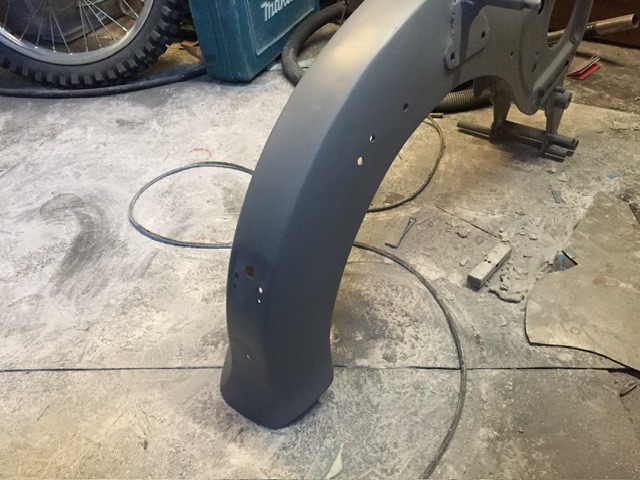

Geoff, I'd love to see the following three photos of how your fender/frame repair progressed.

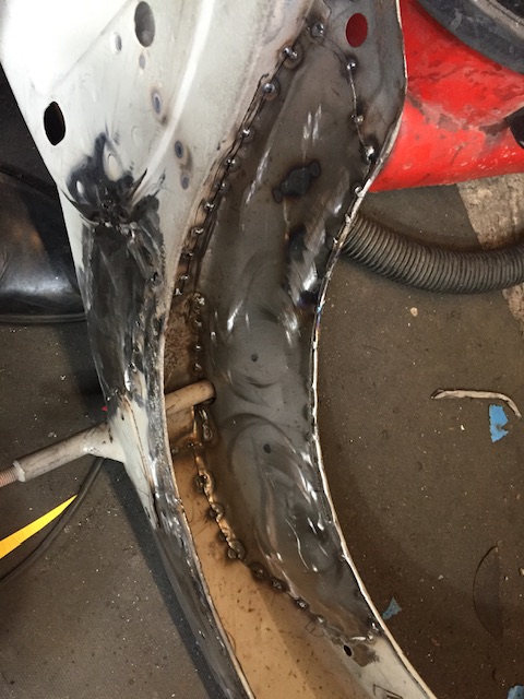

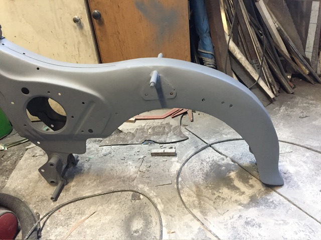

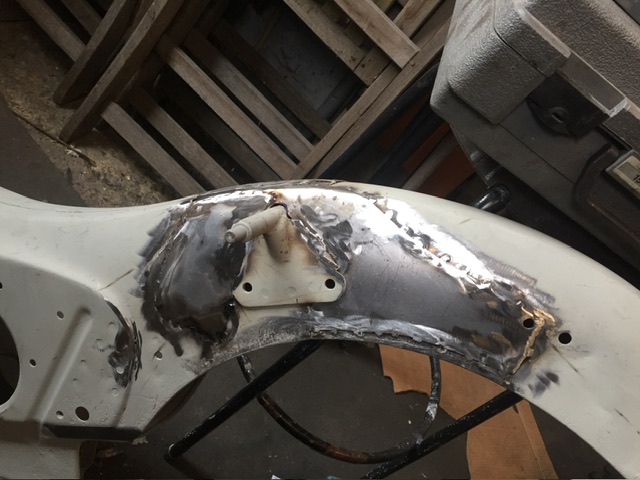

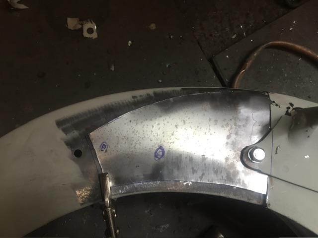

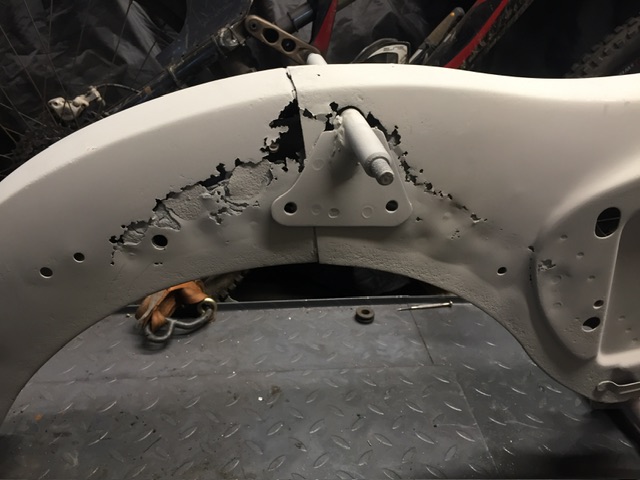

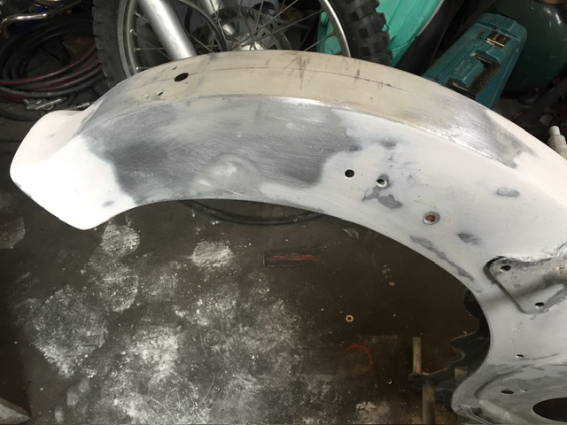

Geoff Hastings
Posts: 378
Location: Epsom, Surrey
Re: C72 from France
Post by Geoff Hastings » Tue Feb 27, 2024 12:20 pm
Hi Michael,
I did post the completed frame repair a while ago but for those new to site I’ll show the photos again. Being double skinned meant I had to do it in stages to avoid distortion. Once near completion I used a laser to check for alignment and tweaked the frame before finally finishing the welding.
