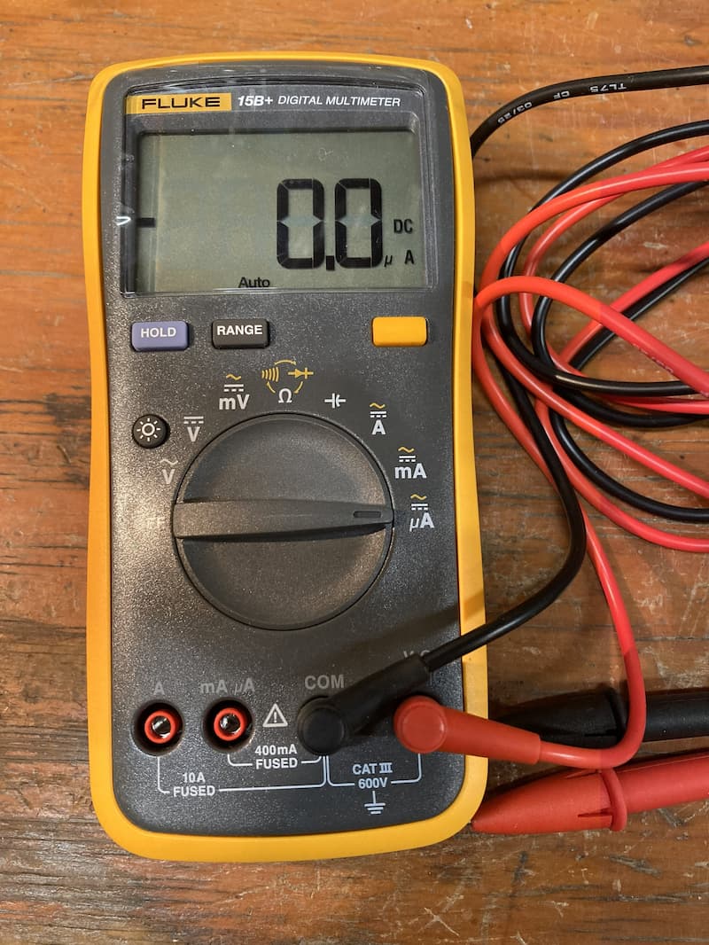

For those that are not familiar with testing a capacitor/ condenser you need a specific meter for that. A lot of the better digital multimeters have a capacitance tester or you can buy a purely capacitance meter. Look for the uf symbol on the dial. You should discharge the capacitor before testing, ideally using a resistor across the leads or lead and body but I’ve just shorted the leads together with no ill effect.

Here is one example of the meter Geoff is describing.
Many uses: In the garage - from ignition capacitors to start capacitors (for your air compressor, for example). You can also get high praise upstairs for fixing the washing machine.

Sorry Michael, but what you showed is micro amps ( uA ) not micro farrad (uf) sorry my keyboard doesn’t have a proper micro symbol. I did photograph my meter but couldn’t reduce the size to an acceptable size.

Geoff, you're right, in that picture the meter is on micro amps.
Posting the correct configuration here - with the meter on farrads. Sorry for the confusion folks.
