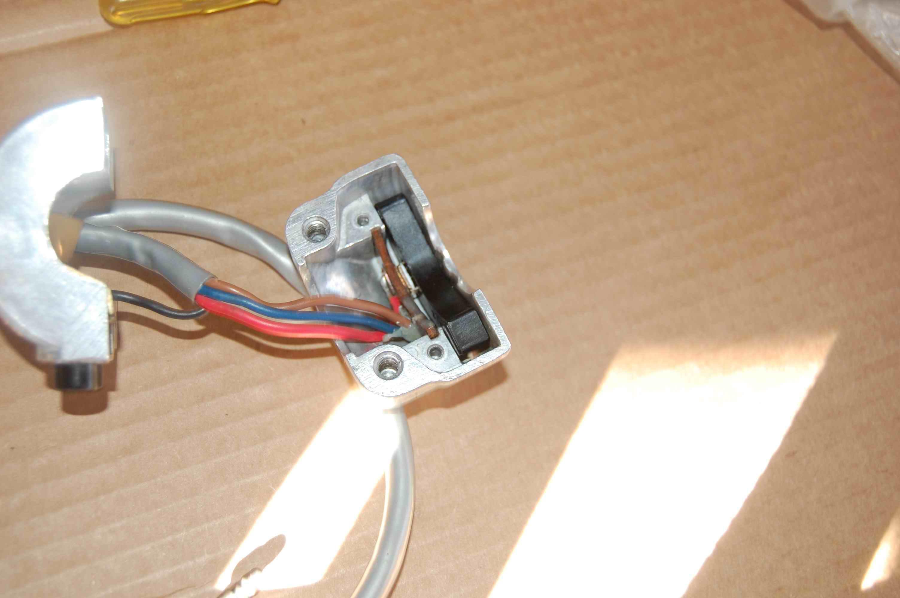

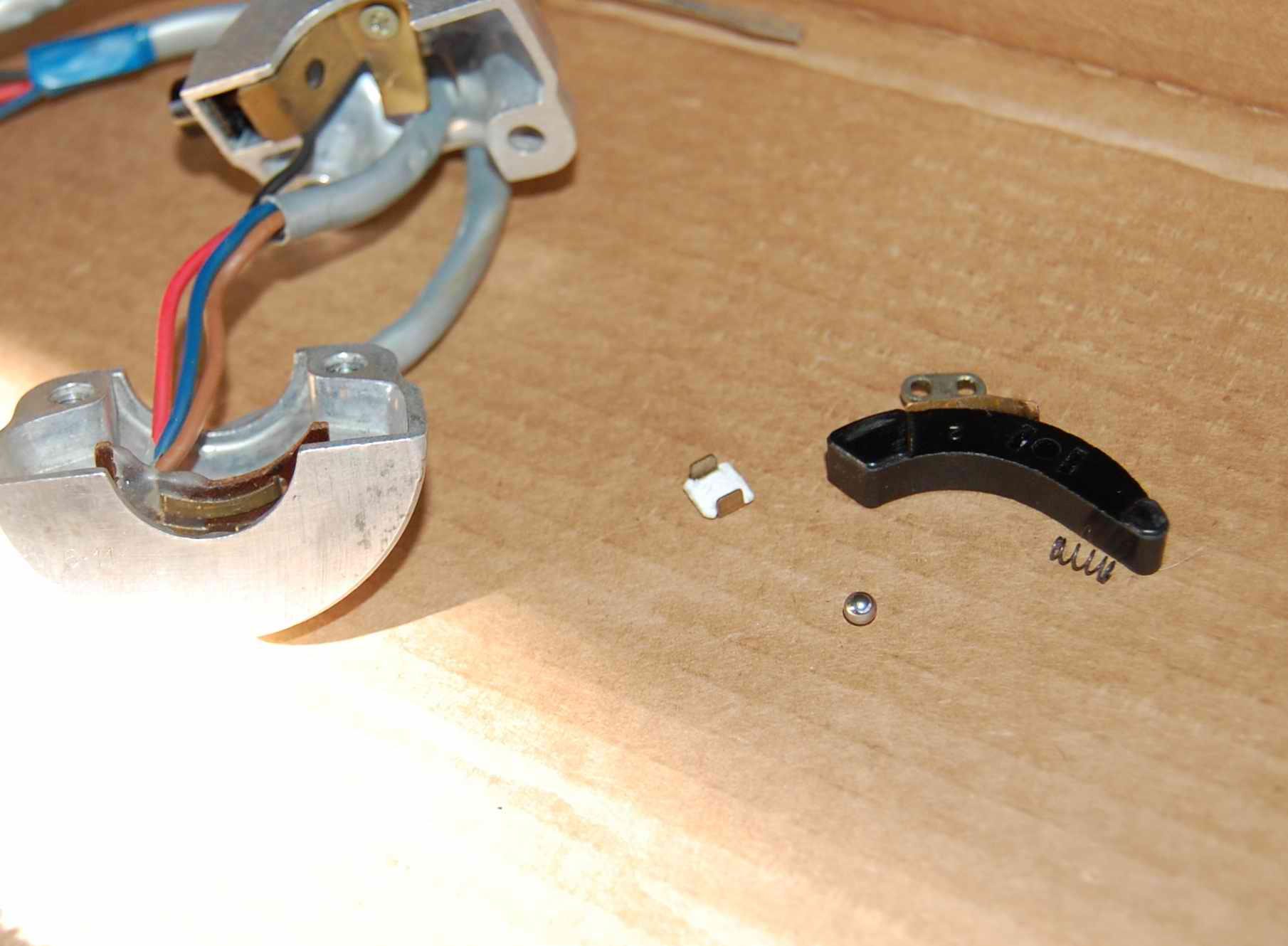

In the meantime I've been refurbishing the handle bar switches and mounting my new short bars. I disassembled the switches, cleaned all the contact surfaces and redid a few bad solder joints. My hi/lo switch was all corroded, had a broken solder joint, and was missing a spring. Its good as new now with very low resistance measured through the switch.

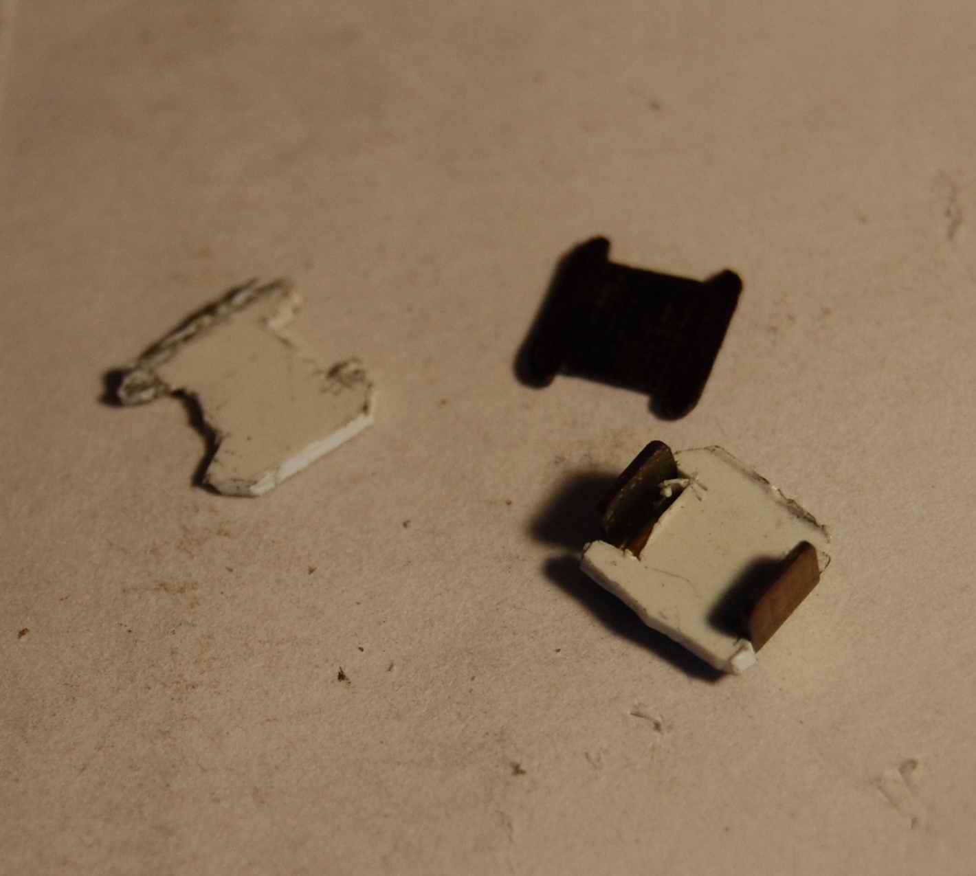

You appear to be missing a vital insulator piece (your third pic down). I made one from an old credit card. Lots of fun putting those tiny pieces together, huh? Nice lookin' bike, btw.
I managed to find an original one, but made one just to see if I could.

Yes that piece was not in my switch. I'm a bit confused...why was this included in the first place? The "u" shaped bridge is making contact between the red or blue and green ground. So if that insulator is not there, the worst case is that you have an extra ground against the switch housing at the 1/8" ball. Why did honda seat the spring against an exposed metal ball anyhow? Seems like all they would have needed to do was seat the spring within the plastic and then no insulation would be needed? Am I missing something here? My switch seemed to perform well testing with my multimeter.
Post by brewsky » Wed Jan 04, 2012 12:04 pm
Green is not ground in your switch (or shouldn't be)....it is the hot wire with a choice of connection to high or low beam from the switch position.
Therefore, if you don't have the insulator installed, the hot wire will ground out thru the ball, spring, and switch case.
Did you test the switch with it attached to the bars and bike?
I had to make an insulator also from a scrap piece of plastic...it is a fun job!
