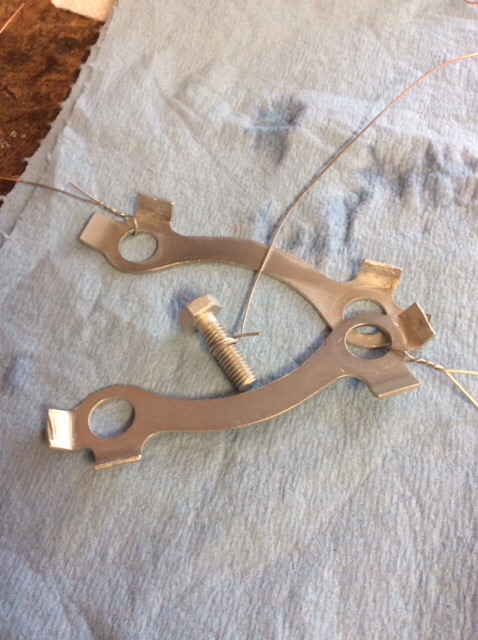

Decided to re-plate the lock washing strips.

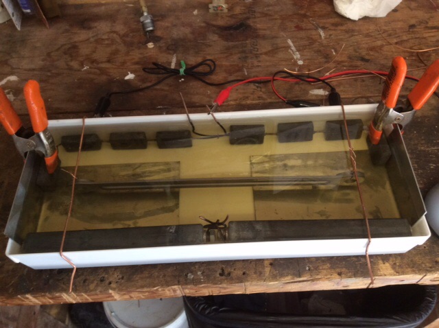

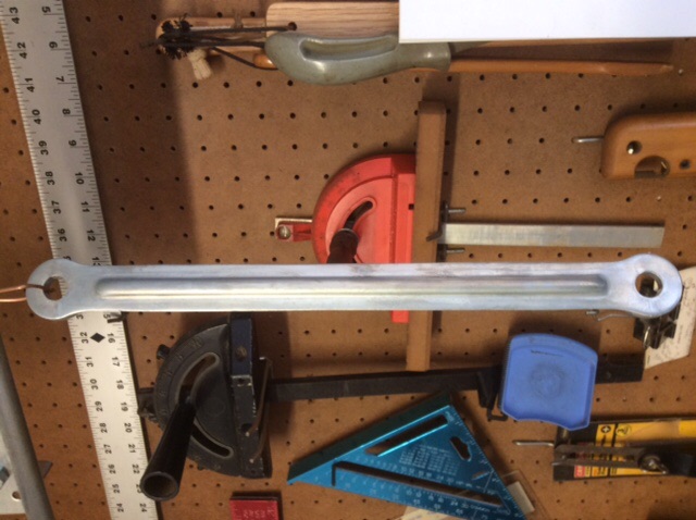

I started scrounging through my dwindling parts bin for bits to plate while I'm still set up for it. I stripped the horn mount and hardware, as well as the rear brake stay, which was really in good shape. As it is with most things, the set up was the most time consuming because I had to create a temporary long plating tank out of a drawer organizer. I plated it this morning. Looks okay.

That's a really nice setup for plating. I need to make the effort and get started.

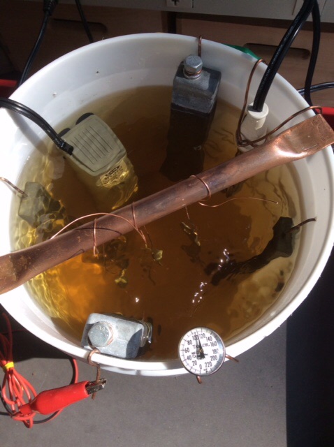

Thanks, G. The plating setup changes with need. You really should try it. It's kind of like that old song "Love Potion #9". You'll start plating everything in sight. It's easy and very satisfying when it comes out right, but it's also very fussy when it comes to cleanliness, so it's time consuming.

Go for it, Steve. Do you plan to mix your own electrolyte or buy it? I've done both and both have their advantages and disadvantages.
