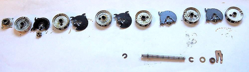

Post by sarals » Sat Nov 10, 2012 4:36 pm
I just finished pulling apart my "parts speedometer". It is in far, far, far, FAR better shape than my original was/is. All of the internals are clean and corrosion free, the lube is still soft, the springs are intact, and ALL of the rubber (glass seal, cushion, rear insulator, and bulb covers) is in nice condition. The only issues it has are the white odometer tumbler is quite faded, as is the face plate. Not a problem - I'll use the nice white tumbler from my original speedometer, and I have a decal for the faceplate. I'll be putting it back together soon!
It's nice when something works out better than anticipated.
1965 CB77 305 Super Hawk
1989 NT650 Hawk GT
1981 Yamaha XJ550 Seca
sarals
Posts: 1014
Post by sarals » Sat Nov 10, 2012 4:40 pm
See what I mean? Nice! By the way, I do know the needles are on the wrong shafts - they're just where they are to protect them and to keep them from getting lost.
