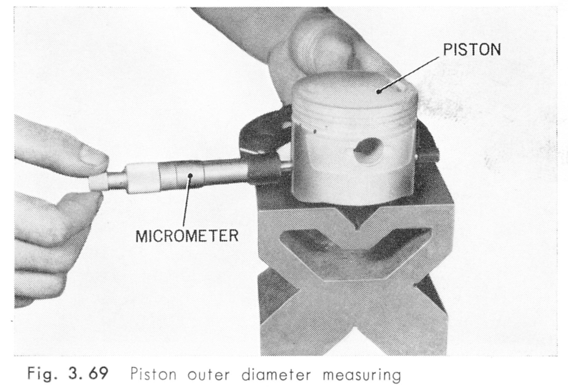

Hi WR,
Good thing you bought a computer. Now about the specifications. The piston should be measured on the widest point. I can explain it in lot's of words, but I thought a picture would be more then useful.
The picture is taken from a bomber shop manual, but the principal is just the same.

Post by WrenchRust » Sun Sep 19, 2010 11:07 am
Can I just say how much I love that manual!!! Freackin' awesome!!! The cross sections of the Transmission with the arrows pointing to how the power is routed through the gears, Brilliant!!! Using that with the Pictures that RW sent to me made this all make sence....
