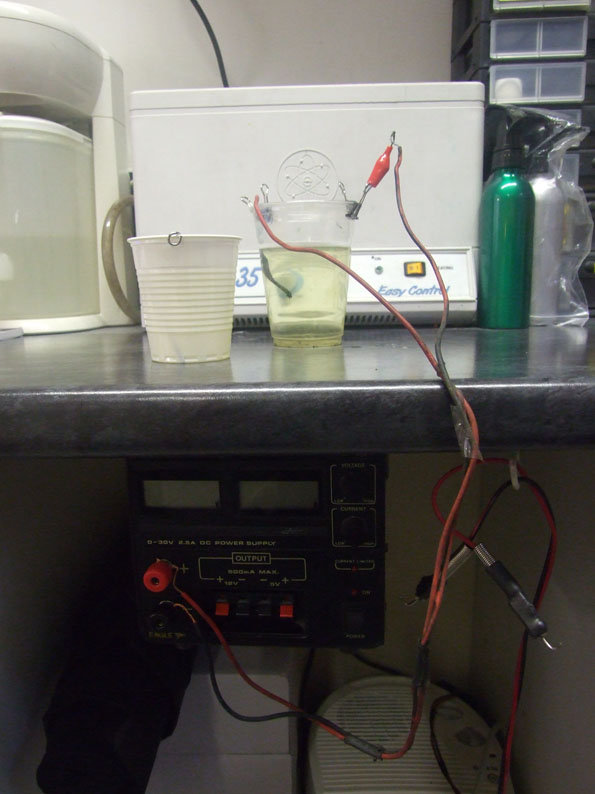

I have been following this thread since you guys started it. I got the zinc strip and am trying to put together by plating outfit.
I went through the whole thread and copied and pasted all relevant comments into a Word document, thinking I would distill it down into a kind of "best practice" kind of guide for myself and to help me put together my plater. But, I find I still have some questions.
First question: It seems to me like there is an optimum voltage/amps combo that should be the target in the bath. It would seem that would drive the choice of parts for the plating setup (if not somebody please set me straight). You had a comment about .85 volts and .85 amps giving you good results, but then there is the comment about the Caswell set up being 1.5 v. Does anyone know if there is a target for volts/amps that optimizes zinc plating?
Second question: I think Snake has figured out that a 1-2 Amp 12v charger or power supply coupled with a 50 watt/500ohm rheostat is a good combination. Others are having luck with smaller amperage chargers but the plating either takes longer and/or works well only on smaller parts. Is this a good assessment?
Third question: I am guessing that my "float" and "automatic" chargers will not work because a guy wants a steady current to keep the plating even. It would seem like a "manual" or "trickle" charger would work okay or just a dedicated power supply, but that would be about it. Is that correct?
Fourth question: I have an old ceramic 300v 100 ohm, 1 amp rheaostat. Physically it looks like overkill, but those parameters are out of sync with what has been described. Can I use it with a different size power supply and hit the target Volts/amps? I am probably going to buy a charger or power supply, so this is important.
Thanks for your help and thanks for all the time you guys have put into this thread. I am really getting excited to get started.
