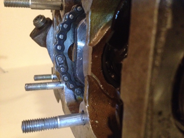

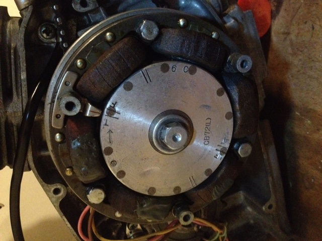

Before completely patching the engine up, my memory kicked in:
Im used to the crankshaft being almost spring loaded (compression stroke?) at TDC making it damn near impossible to hold at T without a rigged wrench. This time, this spring loaded feeling is 180 degrees off at LTDC.
My cam sprocket mark is pointed up, the line on the points cam is pointed up, and my crank is at at T before installing the cam chain. Am i missing something?
Post by LOUD MOUSE » Fri Nov 13, 2015 7:59 am
Have you adjusted all the rockers?. .......lm

Post by LOUD MOUSE » Fri Nov 13, 2015 2:40 pm
Must have been some job to get the chain on the sprocket.
You didn't get the same "T" as you came around?. .......lm
