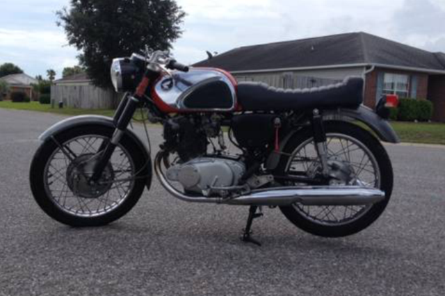

Post by Brickyard » Sun Nov 15, 2015 7:30 pm
Almost there folks! Should look like this in 2 days...

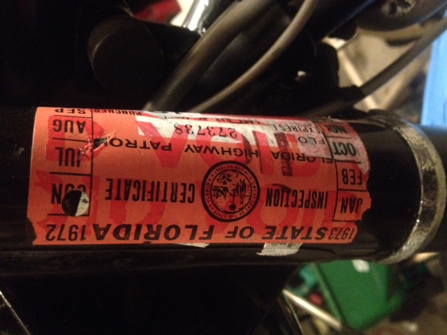

Just learned that my front forks are from a previous year model. Never paid much attention to them other than the inspection sicker that expired 43 years ago (this guys an outlaw!).
Unfortunately they are way overdue for a rebuild and apparently I have to build a tool for that
-_-

Post by Brickyard » Wed Nov 18, 2015 4:02 am
Never have I ever heard sweeter sounds from anything else. I'm confident the donor Pistons and crankshaft were worth it. It's a new bike!
This was the very first start up and I'm happy to say it took 3 kicks:
https://m.youtube.com/watch?v=Q4KkTsnfN ... e=youtu.be
Post by LOUD MOUSE » Wed Nov 18, 2015 6:38 am
Nice and smooth. ...................lm
Brickyard wrote:Never have I ever heard sweeter sounds from anything else. I'm confident the donor Pistons and crankshaft were worth it. It's a new bike!
