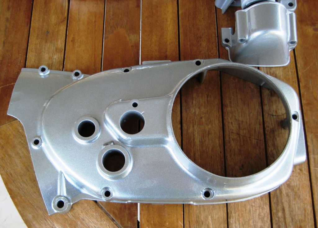

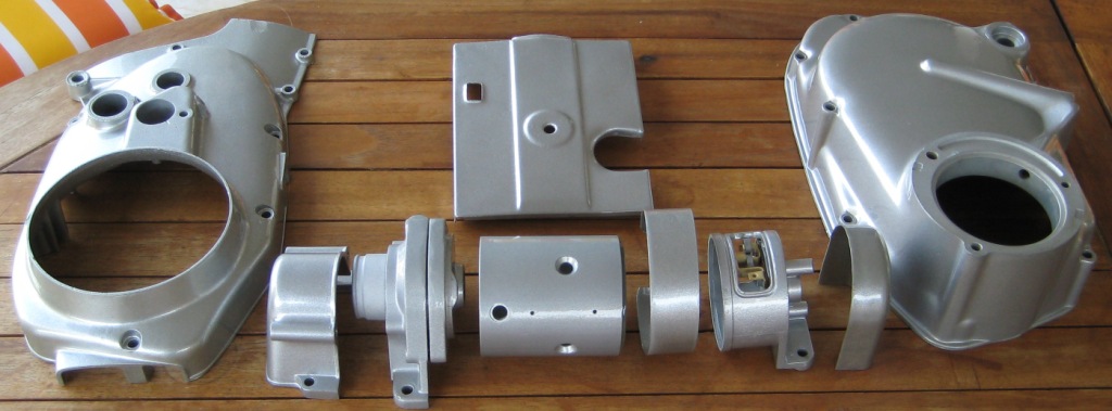

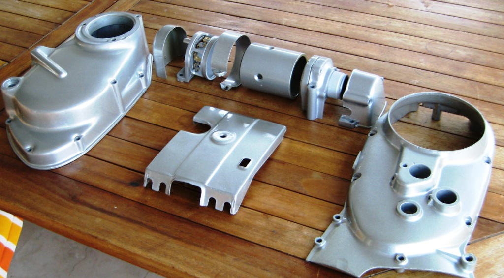

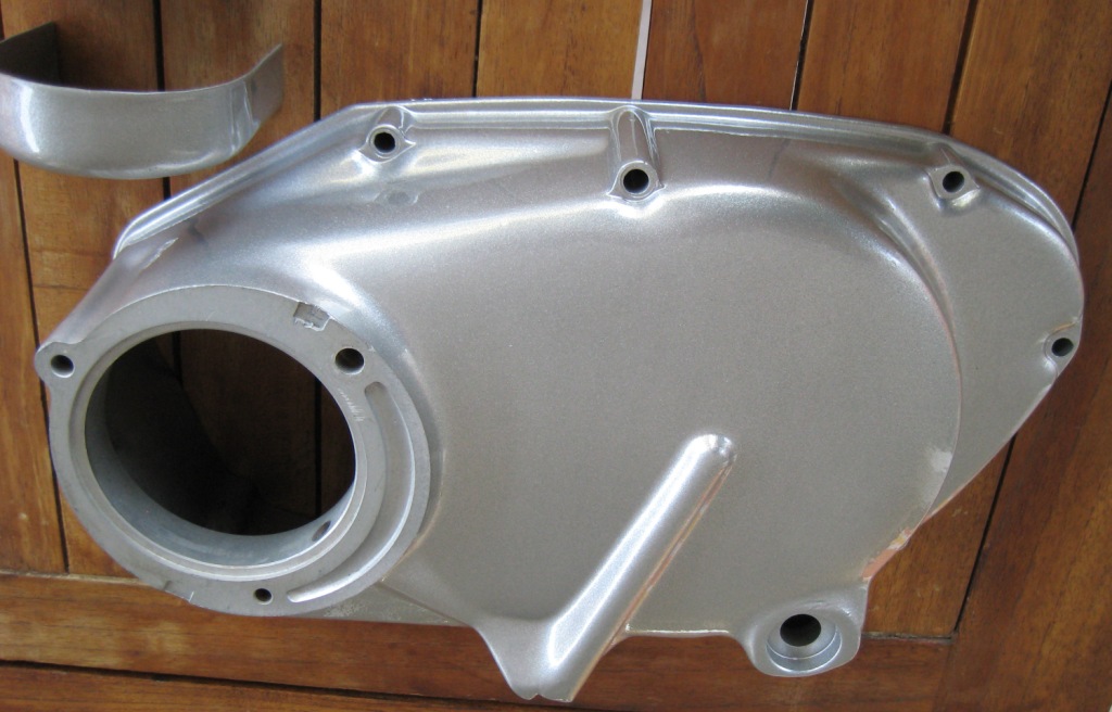

I carted some bikeybitz with me, so when I hit the UK I took my silver engine covers & starter motor to my favourite powdercoating company -- Solent Powder Finishers Ltd in Eastleigh, Hampshire. I've used them several times during the past 25 years and I'm always delighted with the service and the results; this last lot is no exception.
They used the closest finish they had that was similar to Dull Aluminium but it still has a deep metalflake content. I originally opted for the 'no lacquer' option, as the gloss sheen is very glossy; but, after immersing one of the smaller parts in a centimetre of unleaded for a minute or so, and it started to soften, I took the lot back and had it all powdercoat-lacquered and baked again.
The result is pretty sweet, so to hell with Dull Alu!
I'm sending them the top & bottom casings, head/parts & barrels for alu-oxide blasting next week; the raw finish is perfect.

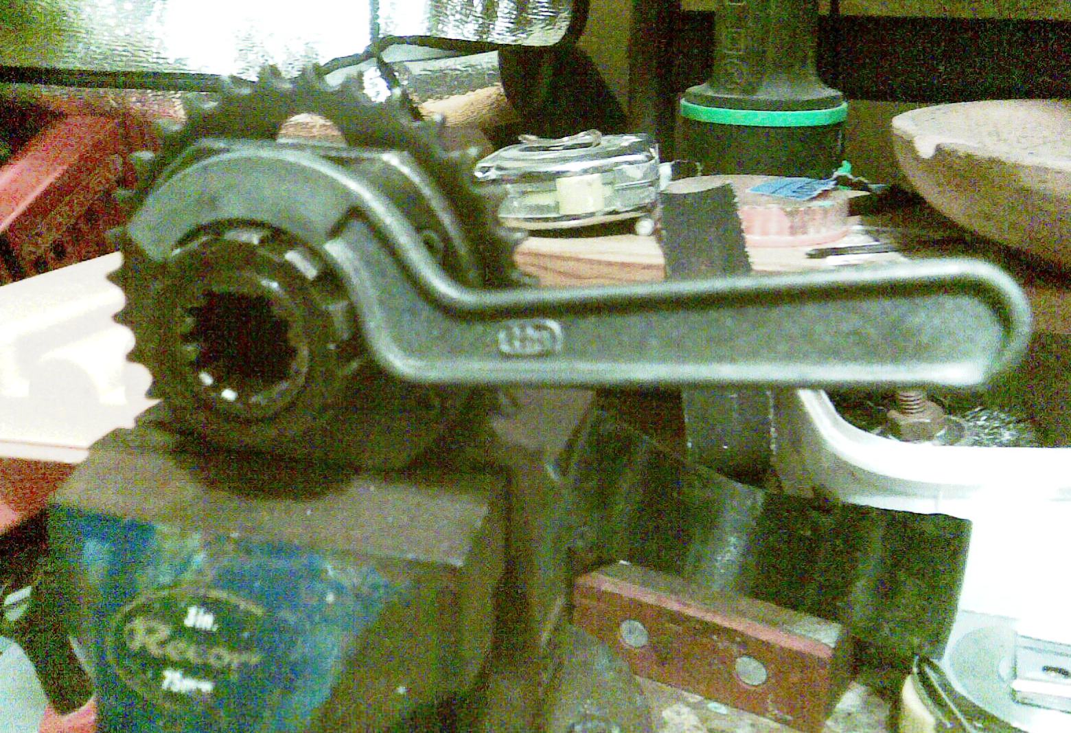

One other thing: am I the only one who has missed something in the many posts concerning the undoing of the cam sprocket nut? Or have I been asleep? See pic; the C-spanner (pin-wrench) for the CB shock adjusters fits the bill perfectly!!

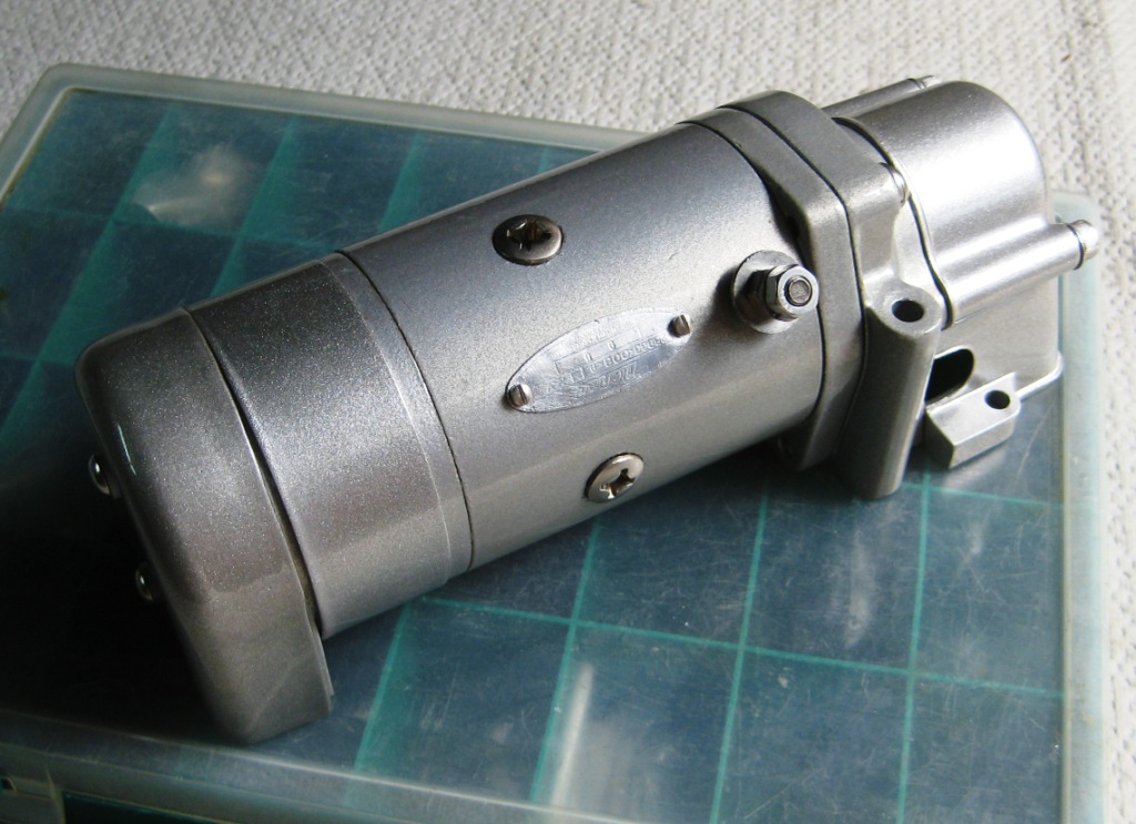

The starter motor reassembly went quite smoothly, if time-consuming. It would've been a doddle, but for the fact that I had to relieve the powdercoating from the facing surfaces. End result pictured herewith:
