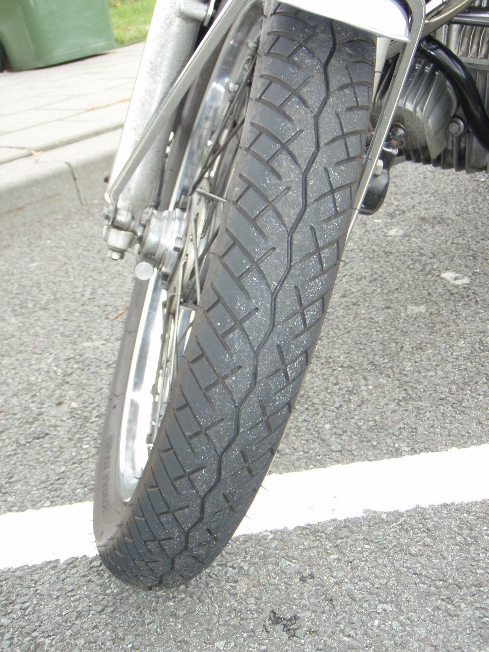

Post by jensen » Mon Aug 31, 2009 11:27 am
Hi steve,
As promised earlyer, close up pictures from the profile of my bridgestone BT45.
(the pictures are from my CB400f, but like I said I have the same profile under my CB72.
I know that the profile is not classic, but handling, grip and safety are more importend to me.
Here in the Netherlands it's almost impossible to avoid highway, so safety first.
jensen
