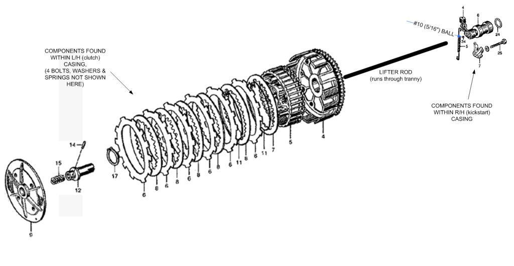

Tight. Just tight. Use a quarter-inch drive ratchet so as not to overtighten. They won't come undone because they're always under tension from the springs.I-man wrote:just read in bill silvers manual 'later five plate clutch plates featured friction material bonded to a metal backing' so I guess it's likely that the metal ones don't separate from the friction ones. interesting. anyone know the torque setting for the four bolts that hold the clutch in?
And yes, all plates should separate from the neighbouring one. The metal plates are 'keyed' on the inner circumference, the friction plates on the outer. All must be absolutely flat, so if you have to prise them apart, then check them for flatness on a piece of glass as D suggests.
I've put together a logical collage of the relevant clutch parts in the pic.
EDIT: clutch component picture added
