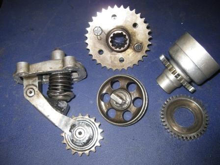

Don't know if this is the best thread for this ? and it is a bit late but here is a picture showing a sprocket style tensioner and steel roller set up. It is copied from a Yoshimuria modification.
I should say I have only used it for racing but it seems to work well.
Gordon

Interesting mod, GB. I'd think that Honda used the rubber compound wheels to suppress mechanical noise. Delrin wasn't as available, if at all, in the '60s, but I'd thing the original wheel works, and has worked, perfectly well for over forty years!
A metal-to-metal sprocket would be, I imagine, a touch noisier than the softer wheel/roller. Let's face it, the mechanical noise factor isn't much of a problem for a race engine.

GORDON BROWN wrote:Hello
Gordon
SAFOJ
Excellent picture Gordon. I appreciate the input. Was there a substantial increase in noise with the metal on metal?
