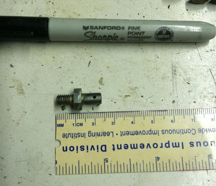

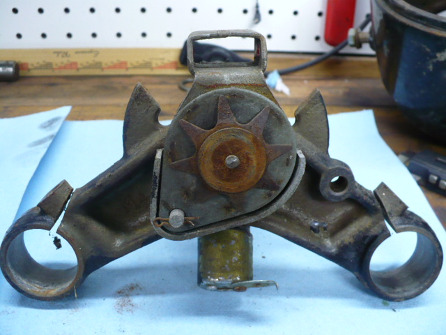

90118-268-000
Dana, I'm sure it's going to be 90118-268-000. It matches your discribtion exactly. It screws into the bottom of the steering stem and anchors the steering dampner.
