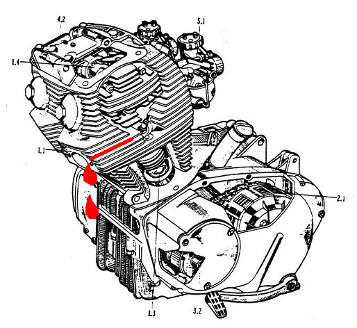

I'm not sure what information I should repeat to update everybody. I don't have a current picture of the engine, but I'll attach where the leak is, it's definitely coming from the head gasket and not the camshaft cover. I can shine a flashlight on the head gasket as it's running and I can see very small bubbles forming. It doesn't leak profusely, just a steady drip once the engine is turned off.

- HGSEDrip.png (90.11 KiB) Viewed 3912 times

Are you sure it is not the side cover on the head that covers the cam? Mine leaked from there. I cant recall if the rocker pivots weren't completely home or there was damage to the mating surface but it was weeping down the front of the motor. I ended up cleaning thoroughly and using a silicon sealant as well as the gasket and it fixed the issue.
I agree. The leak is above the head gasket and unlikely to be from there. Either the cam cover or the dreaded separation of the combustion chamber "skull" from the head casting.
