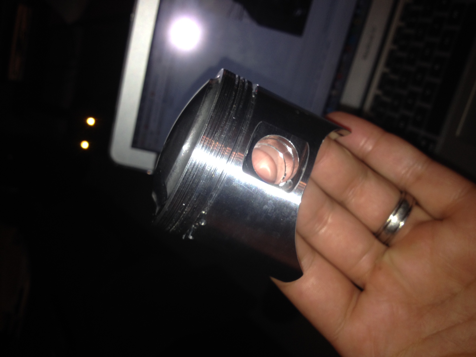

G-Man wrote:Brickyard

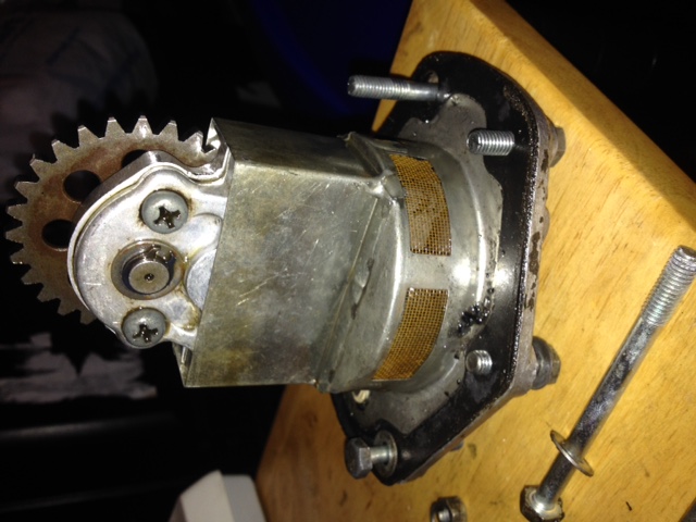

Those pistons look pretty nasty. The oil ways you show in your video are there to catch oil flowing back down from the top end (cam tunnel) to provide a bit of feed for the main bearings. The main oil source to the main bearings is direct from the oil filter and is related with the oilway you point to at the front of the top crankcase.
I suspect you have debris in your oilways and this debris could be blocking flow into the crank and then up to the cylinder / piston area. The piston / cylinder lubrication comes as oil thrown of the crank / big end.
You really need to strip the motor and clean all those oilways tyou can find as well as cleaning
the the centrifugal oil filter and filter screen around the oil pump. If you can, you should get the crank stripped and cleaned, as well, No oil to that piston probably means that the oilways in the crank are blocked.
The debris from the 'dry' piston is going to make the situation worse.

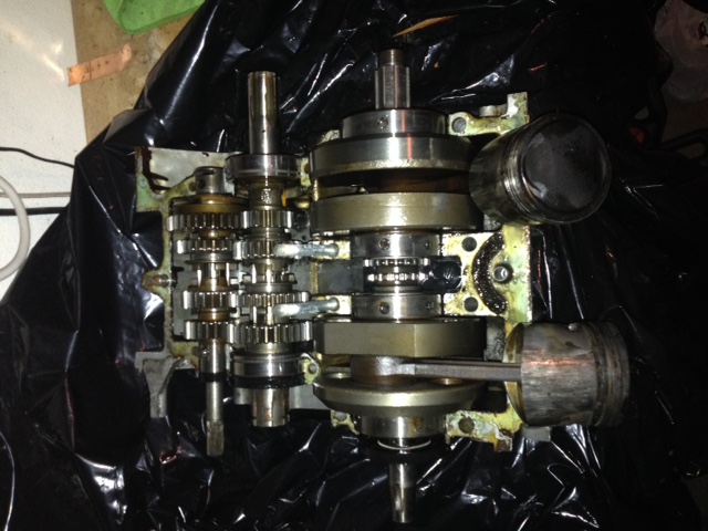

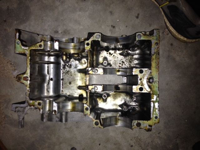

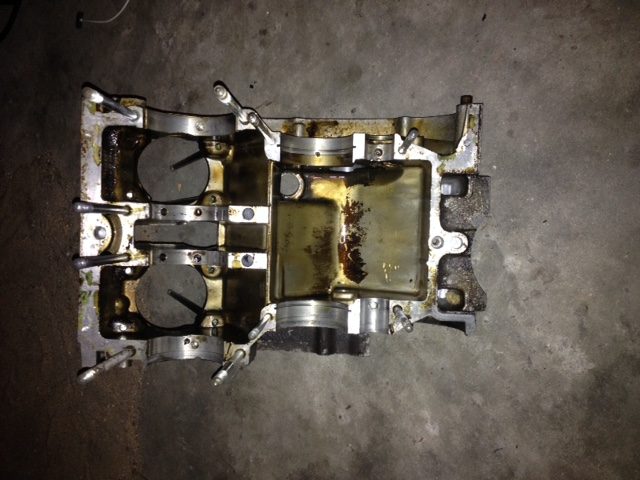

Post by Brickyard » Tue Oct 20, 2015 7:44 pm

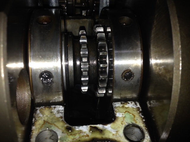

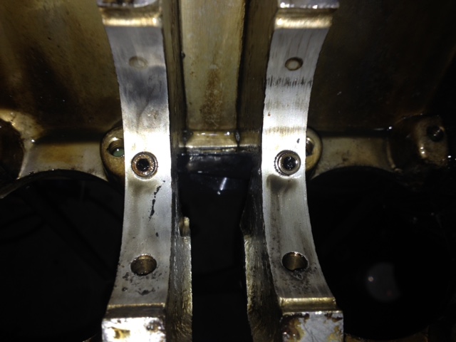

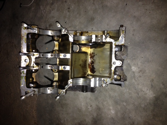

Split the cases. Going to remove the internals and bring the cases to an auto shop for hot tank cleaning, but not before I clear these ports...
Anything wrong with me hot tanking the crank shaft and or transmission gears as a whole assembly?

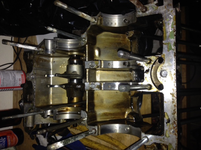

Cam roller parts in every crevice...

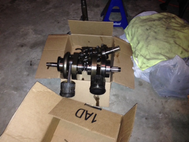

Post by Brickyard » Tue Oct 20, 2015 9:56 pm

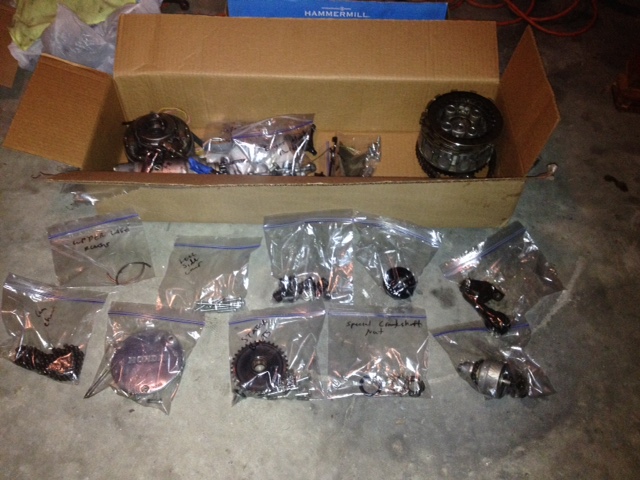

Tear down wasn't as bad as I thought.
