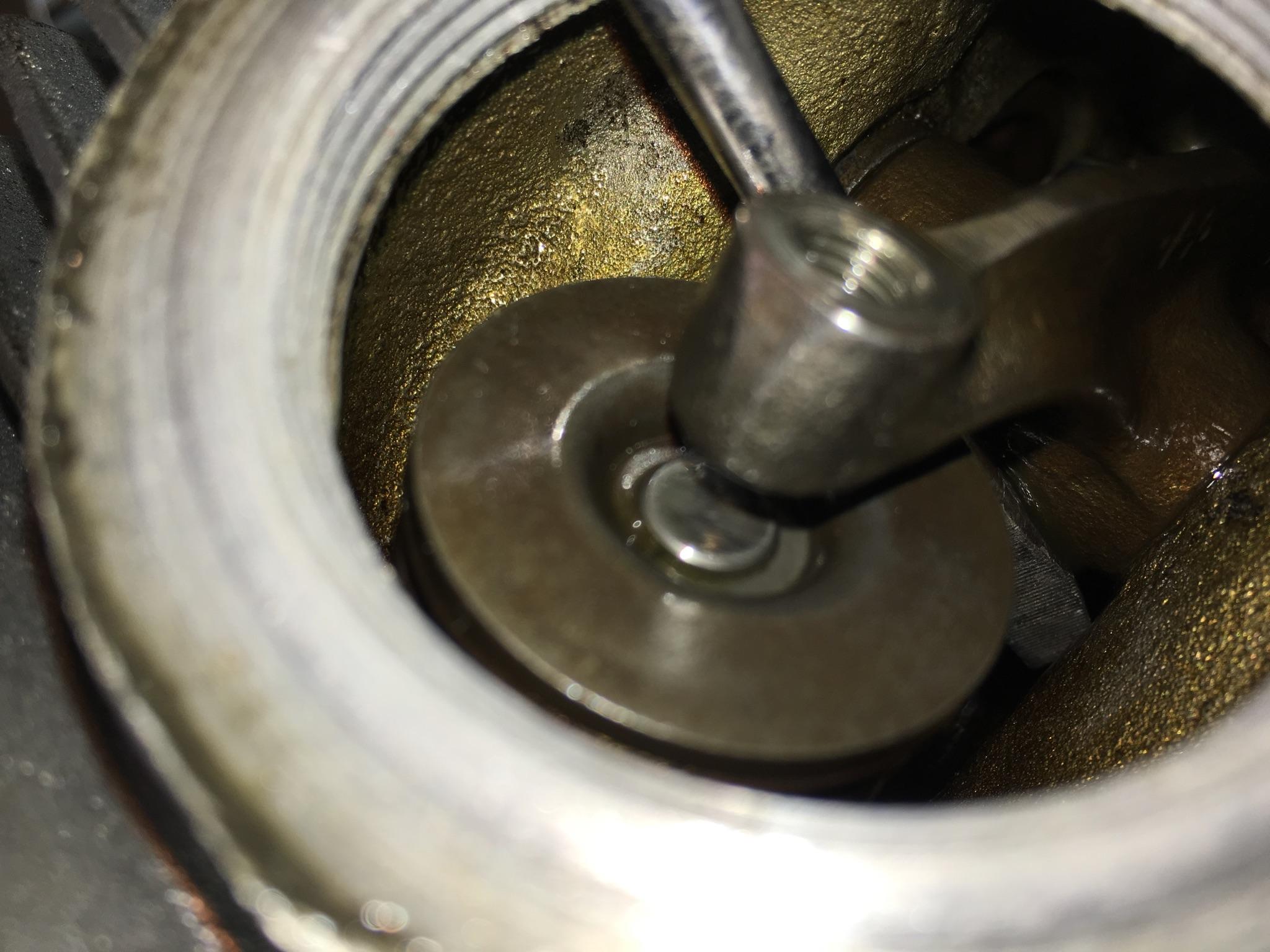

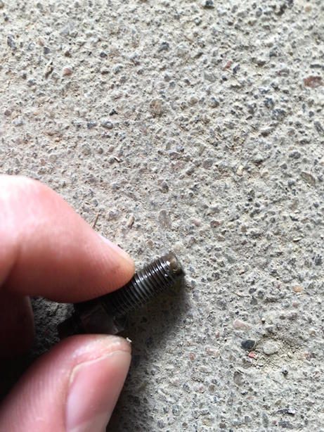

Here are two pictures. This is from my right exhaust valve, I cannot tell if there's any dishing on the actual stem although it doesn't look like it.
The actual tappet is very flat comparably to what I think it's "supposed" to be.
I rode the bike probably 50 miles today and it works great, only at idle and lower rpm does it make the loud clicking/tapping sound. I'm almost getting used to it now.

Post by LOUD MOUSE » Sat Mar 19, 2016 2:01 am
There is your noise.
This part as you show it should have a DOME rather than a FLAT end.
The valve stem looks good. ....................lm
