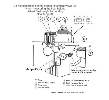

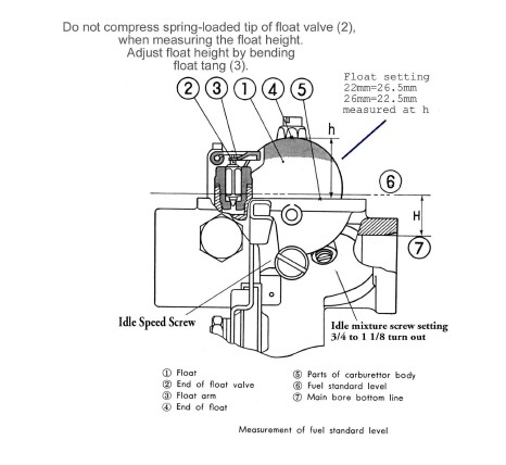

It is always very hard to diagnose problems remotely, but here are a couple of things to try (courtesy of Bill Silver and others):
Make sure the carburettor mounting flange is not excessively warped. Almost all used carburettor bodies will have warped mounting flanges – make sure it is not excessive. A large flat file will flatten the flange area out if needed and used carefully. If a new O-ring is installed, the carburettor mounting nuts must be just lightly tightened, otherwise more bending of the flanges will occur.
Check carb floats for any pinholes, to prevent “sinking” once the float chamber is full.
Check that the carb float height is set accurately and correctly – 26.5 mm for Keihin carbs.
Ensure the carb slide needle is set at the correct height. Remove the jet needle from carb slide and install the clip on third notch from the bottom (of 5 notches). Make certain that the clip and needle are securely fastened in the slide before re-installation.
Check that the carb slide is orientated in the carb correctly and that it slides up and down freely.
Clearly identify the carb idle mixture screw and carb idle speed screw – these are different and it is essential to know which is which.
Turn idle mixture screw in lightly to the stop. Open it back out about 3/4 to 1 1/4 turns.
Turn the idle speed screw in until it just begins to raise the slide, then add about one-eighth to one quarter more turns in to give the engine an opportunity to fast idle initially.
With these settings the engine should start, but will need choke. If it does not need choke, there is probably some setting/s incorrect.
Once the engine is warm and idling with no choke, check the ignition timing with a dynamic timing light. Ensure it fires on the “F” mark at idle. Check to ensure the spark timing does not advance further than the 2 firing marks on the rotor as revs are increased above around 2,500 rpm.
Check throttle response. If there is a hesitation or “spit back”, when the throttle is opened, turn in mixture screw (air screw) 1/8 turn at a time, until response improves.
At all times and for all adjustments, record the original position, the new position and the observed changes in performance. Never adjust more then one setting at a time, before observing results.
