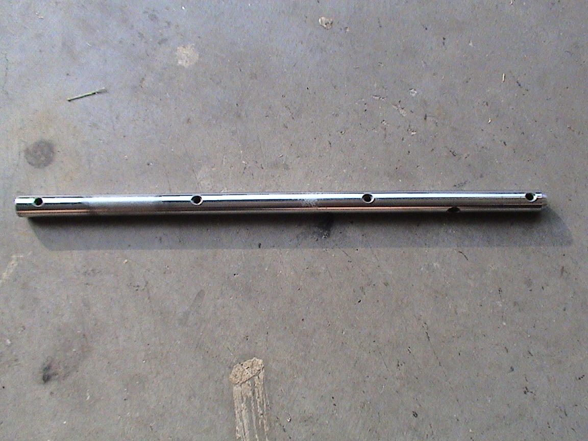

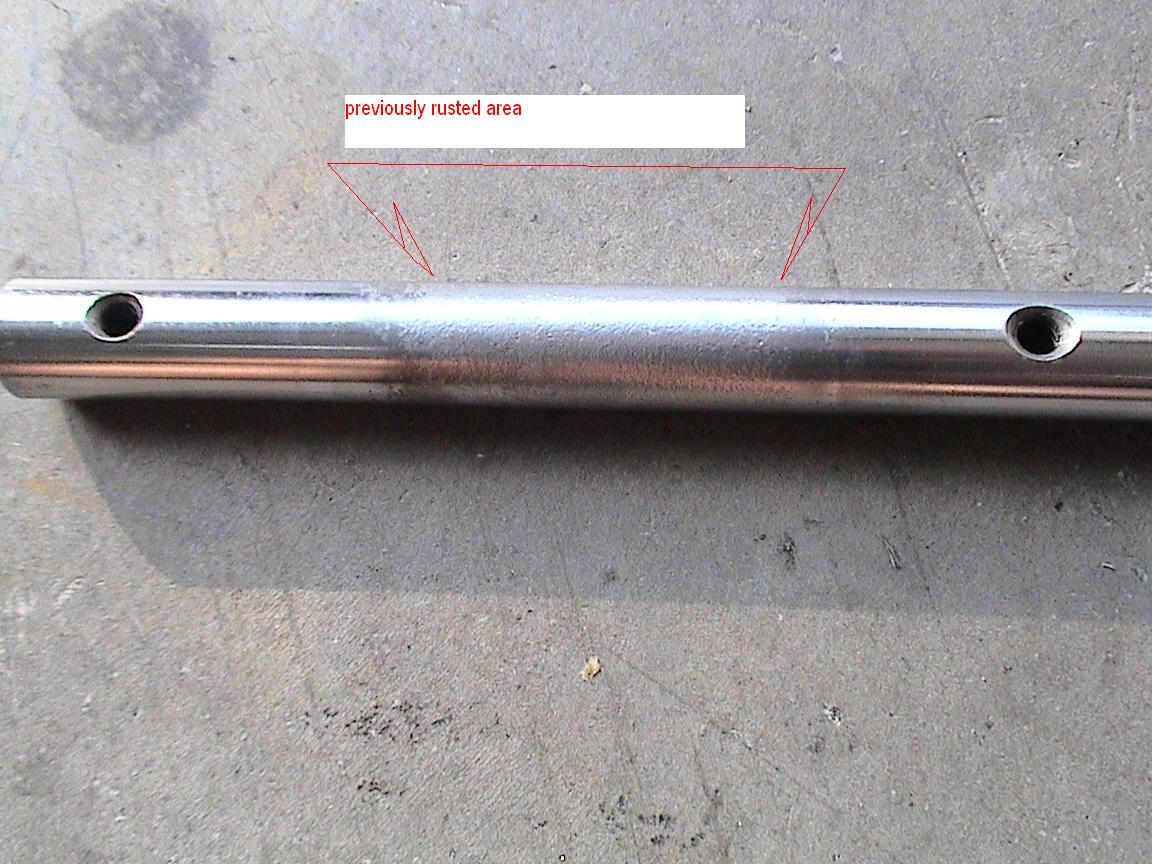

Update to an attempted repair of rusted chrome throttle shaft:
This shaft is from a bank of CB550 carbs. The exposed area between the carb bodies was rusted pretty bad in one area and slightly in another.
Wire brushed the bad areas, dipped in Works toilet cleaner for a couple minutes, rinsed, dried and immediately immersed in plating solution.
This is the same batch mixed up last April that I have used several times since. Only took a few minutes with the 2 C batteries.
The plating brushes off the chromed areas easily with a brass brush, but sticks to the pitted areas.
Not perfect, but way better than a rusted area, and hopefully prevents any further rusting.
