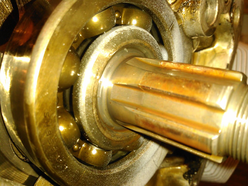

Hi Jensey
Paint and dirt? In the disassembly pictures? You can Presume I assembled the motor using basic mechanical hygiene. I don't like doing work over. Have a great day!
I'm sorry I bothered you, I was looking at this picture and was wondering what the white / grey "dust" was.
Anyway, good luck with your show, and thanks for time you took to respond to my post, have a nice day,
