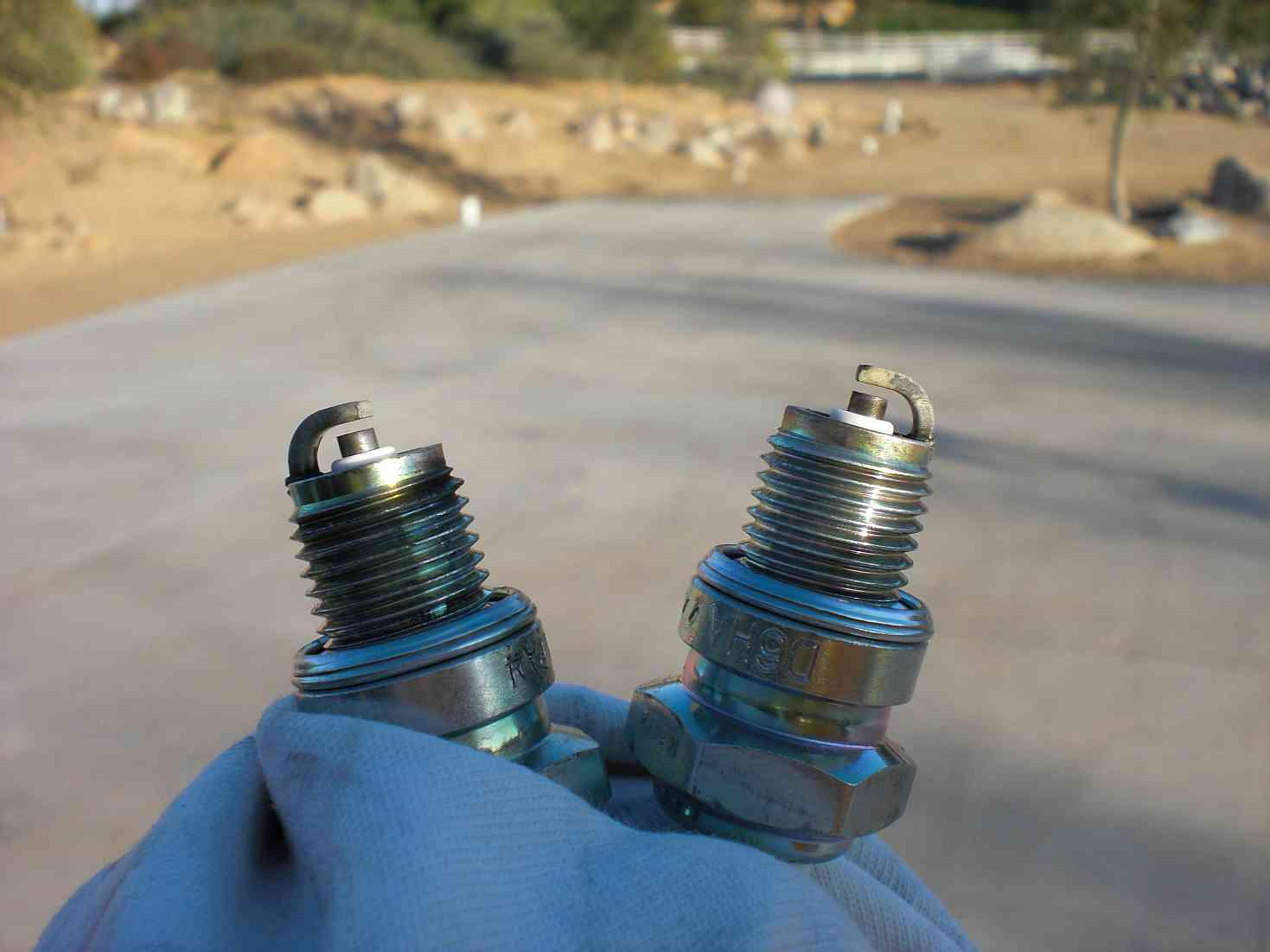

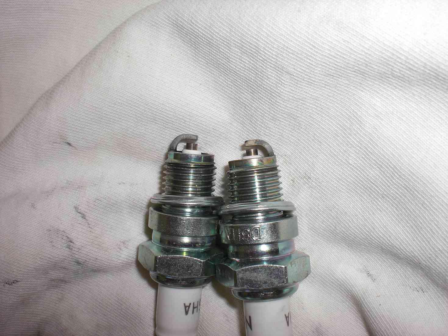

Check out these plugs!
That was it! I can't believe that I had the screws mixed up. I should have look more closely at the function of those 2 screws. I simply looked at how they were labeled in the parts fiche and went by that. I think that the fiche shows the round bowl version while mine is the square bowl type. Maybe that accounts for the incorrect labels. Who knows.
At any rate. I moved the needle clip back to the middle and reset the floats to 26.5
Turned out the air screw 1 1/8 (the screw on the left!) And set the idle just enough to lift up the slide a bit.
Man, what a difference. The bike was quick, and ran perfect.
And finally, after about a 4 mile ride, I pulled the plugs. Sweet! No soot. Maybe even a touch on the lean side.
115 main and 35 slow.
Thanks, I was so happy I started jumping up and down.
Bryan
Bryan
- h305 Moderator
- Posts: 2600
Nice going Bryan. I'd agree, looking at those pics, that it looks a touch on the lean side. And the float height for a PW26 carb is 22.5mm from the lip. 26.5mm is the height for a PW22 (247cc).
Take the carb off again, set the float at 22.5mm, re-assemble and take a ride. If, after a few miles, the plugs aren't a sandy, beige colour, then lift the needle a notch and ride again. That 115 mainjet may be a tad small, but I reckon setting the float height correctly, thus raising the fuel level closer to the throat and increasing the level at which the fuel rests within the mainjet (needle-jet) pick-up tube, will help overcome the weakness. Don't run the mixture lean; the resultant overheated combustion could prove tragically fatal for the pistons (holing) or exhaust valve seats (burning).
With a 115 main jet ya can bet you are far to lean.
Install a 135, set the float and adjust the screws and ya won't hole a piston. ...........lm
bj wrote:Check out these plugs!
Bryan
