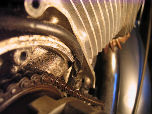

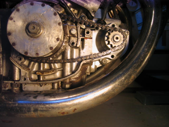

I note that the starter chain has a goodly amount of slack...in fact it's slightly brushing the case at the bottom, photo attached. I've read a similar post where someone had concern about this and was told don't worry. I don't see an adjustment mechanism anyway.
I also see that the insulation around the starting motor cable has been scraped away...perhaps this can be seen in the attached photo. I don't know what could cause this other than the starter chain, but it doesn't seem possible that there would be enough chain lash for it to reach that high. Perhaps this is something that occurred in the past because the cable slipped down closer to the chain at some point.

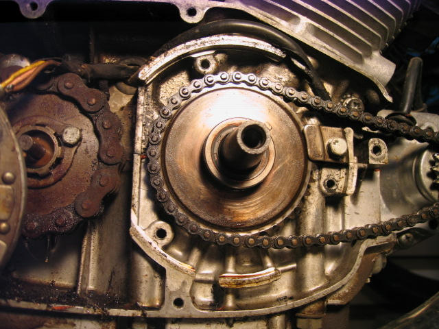

Trying to get the rotor off...removed the stator so far so good. I see Bill Silver's book directs me to "use the special rotor puller bolt to the remove the rotor/starter clutch assembly." I looked up this special tool in the official parts manual and see a tiny hand-drawn picture of what appears to be a bolt. Its specialness is, um, obscure. So...can anyone tell me what's so special about this bolt, how it might be used, or if I could substitute the use of one of my various steering wheel pullers or two or three or four jaw pullers I have laying around?
Also, Mr. Silver's book talks about disconnecting the neutral switch wire connector and removing two screws holding the neutral switch. I don't see any reference to these parts in the parts manual and it's not obvious to me what this is or why it needs to be removed. Any help?

Nuetral switch is above trans shaft, and has a seal behind it as well. Unless it appears to be leaking, no need tp mess with it. Check out this thread for rortor removal tools. http://www.honda305.com/forums/viewtopi ... l&start=20
The chain does seem to be hanging pretty low, you may want to think about finding a replacement. I installed a NOS one on one bike, and it still was loose, though not a s loose as yours is.

The part I was missing was removal of the rotor setting bolt. Clearly this bolt must be removed before inserting this special rotor removal bolt. Bill Silver's book didn't describe this necessary step, I'm guessing because it's important I feel like an idiot.
Any reason a guy couldn't simply use a three jaw puller in this situation? Using a smaller bolt or piece of steel rod inserted into the hole?
No big
I put a 14mm wrench on the stator bolt and smacked it. It loosened right up and I removed it. Then I put a 1/4" x 2" flathead bolt in the hole and attached my three jaw puller. Had it off in about 20 seconds.
