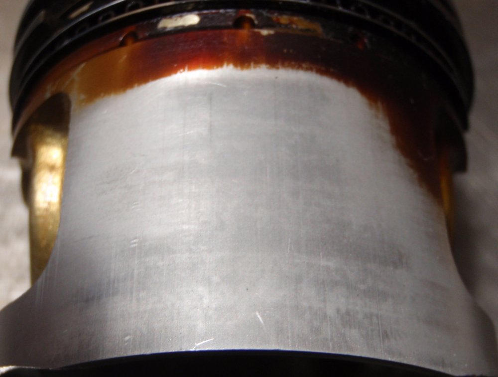

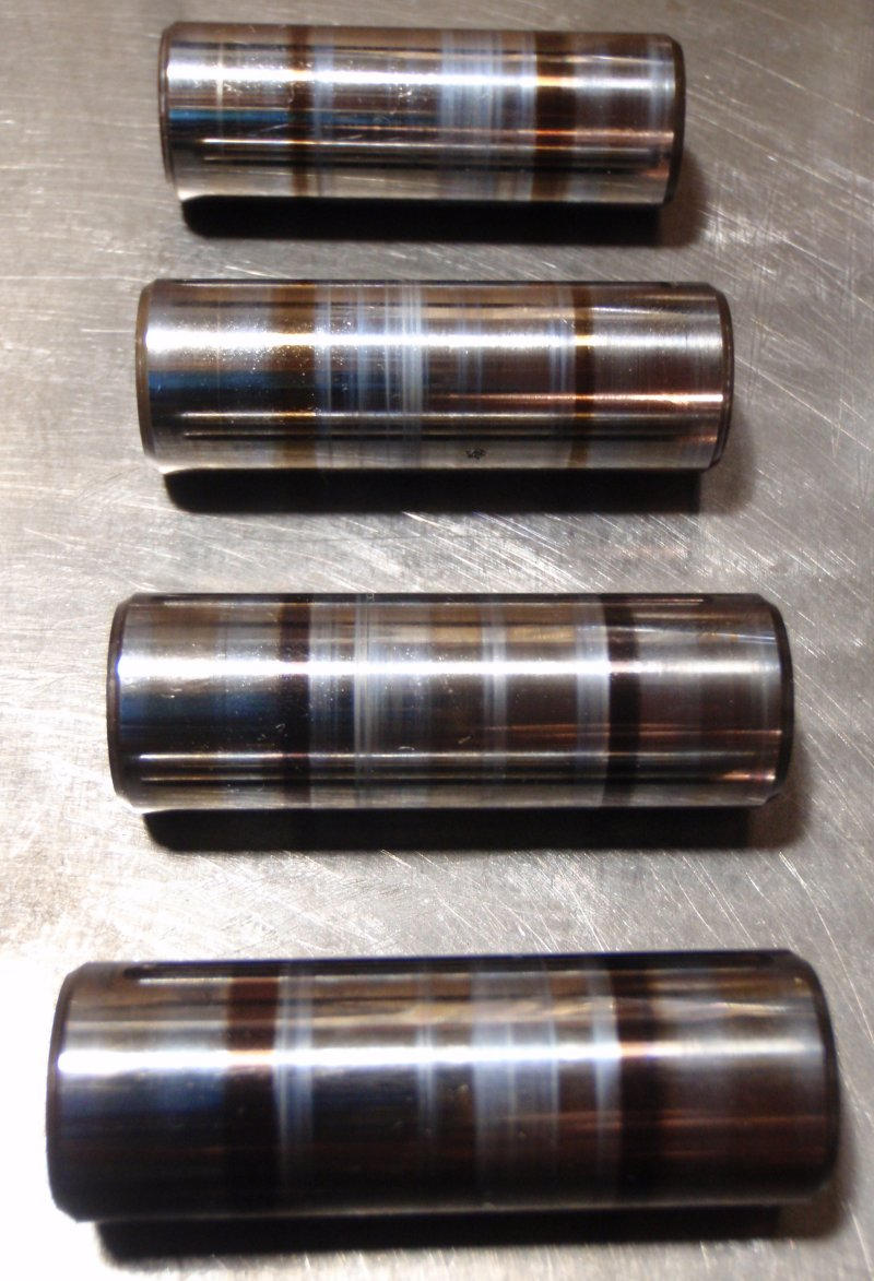

Now, this are pictures indeed. It shows a few things, starting with the pins. Don't bother re-using these piston pins, they are burned. What bothers me is that one of the pins did turn around in the piston itself, it shows wear at the outside.

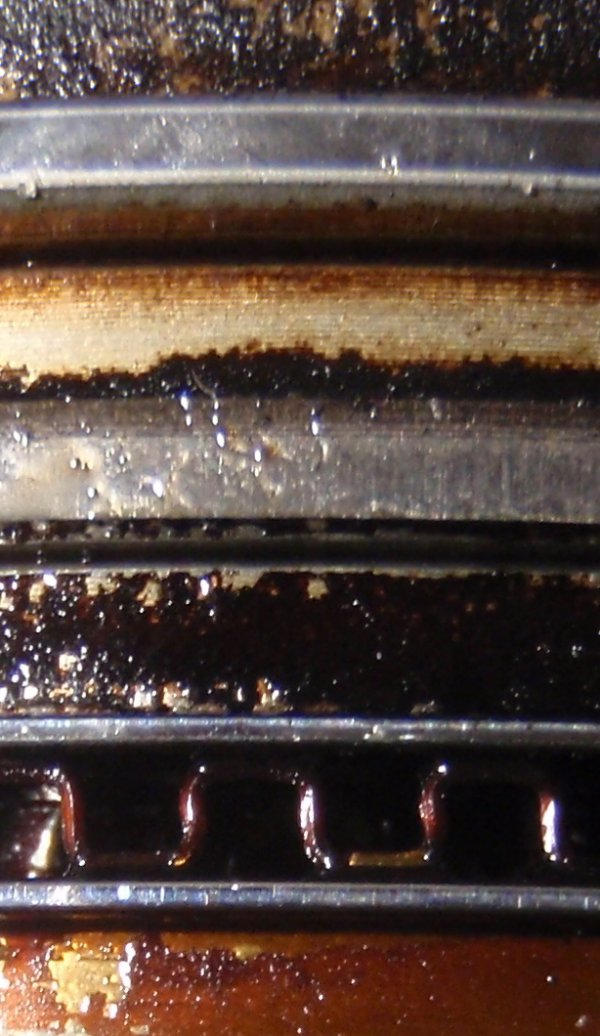

The cylinder bores are not fine, rebore and hone. You see the hone structure clearly in the underside of the bore, but in the area were the piston rings were, this structure is gone. This could be regular wear, but I think the rings did not have enough end play. Did you check the slot play of the piston rings before assembly ? Furthermore I see lot's of oxidation (rust) in the walls, this is due to condensation of the wall when the engine stands still. Maybe next time when you're planning not to ride it for a while, put oil into the plug holes (a few cc's) and kick it a few times, and repeat once a month.

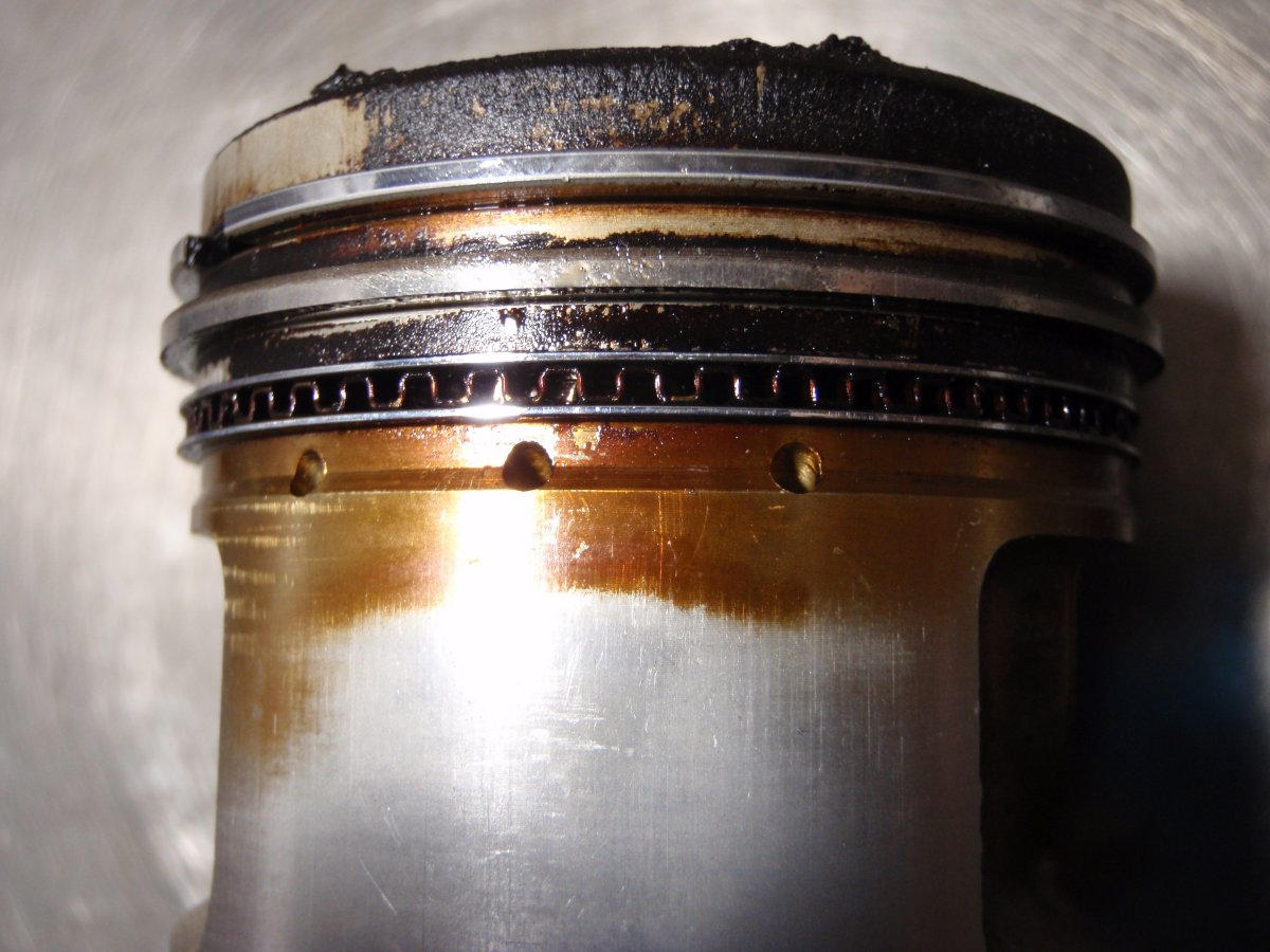

Both pistons are in bad shape, especially in the area where the pressure between the piston and cylinder wall is big.
Find some new pistons, rings and pins. rebore the cylinders, hone them, check your small end (con-rods) with a new pin, and check your oil pump (just precaution).
