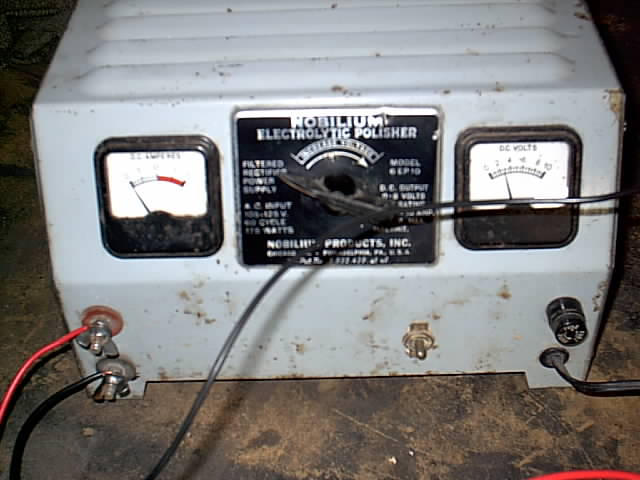

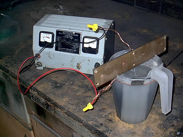

Wilf; thanks for inspiring me to try some home plating. I've had the equipment sitting around for a few years, but was put off by the need to order solutions/anodes. I tried your mix recipe and I must say it works pretty well. I am finding that a couple 10 min soaks with polishing between seems to be the ticket. the voltage source is a "Nobilium electrolytic polisher". dental lab stuff. pretty cool.
Thanks
Randy

Post by Wilf » Fri Oct 15, 2010 10:27 pm
You're welcome, Randy.
I'm glad you tried it--it really is satisfying!
What I wouldn't give for your power supply--it looks very useful indeed. But I think my "Electra Sol" plating bucket is the secret for serious platers :)
Wilf
rrietman
Posts: 561
Location: bellingham wa.
Post by rrietman » Sat Oct 16, 2010 12:33 am
W; you are right , the Electra bucket is the stuff. I tried to find one but was put off and had to settle for the cheapo plastic pitcher.
Randy
