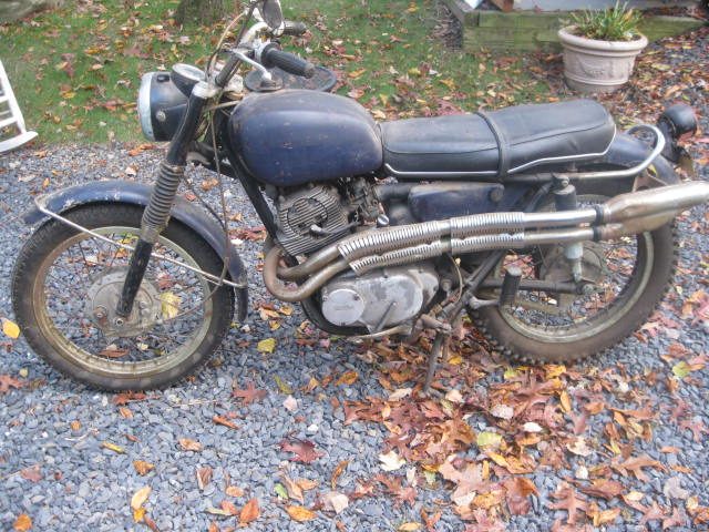

Just sending power your way, that baby was just a bit crusty. Looking forward to progress. Your bike makes mine look like showroom.
Honda CL 77 001.jpg (86.04 KiB) Viewed 4172 times
