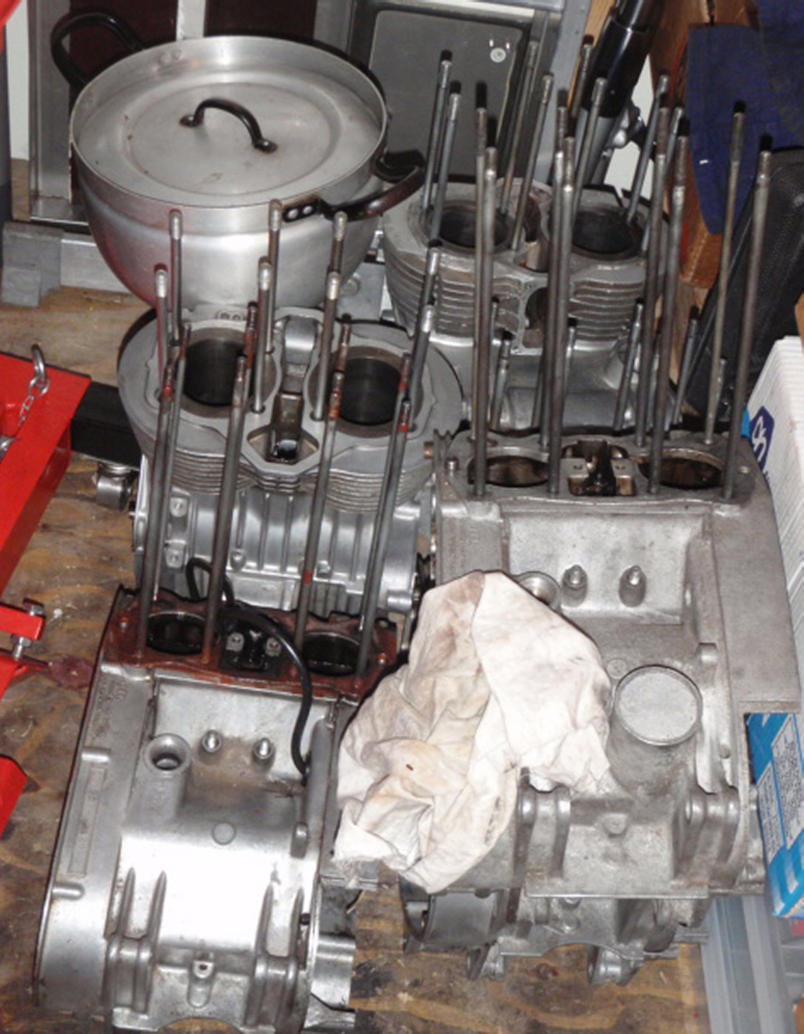

jensey
Posts: 384
Location: Netherlands
Post by jensey » Tue Apr 07, 2015 3:53 pm
I know what you mean.
engines everywhere.JPG (362.12 KiB) Viewed 3251 times
