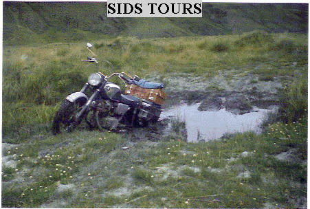

I have been running 300/18 front tyres on my cb77 for the past 40 years and never had any noticeable differences or problems with the handling or fitting. They have been assorted brands and preferred AVON SPEEDMASTERS. I used to get 7000 miles from each rear and 21000miles from the front ribbed one. AVON still produce these tyres but look up the website for sizes. I just run what I can buy now. I even spent a summer with a set of 300/18 trials tyres on the bike.
