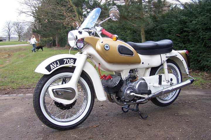

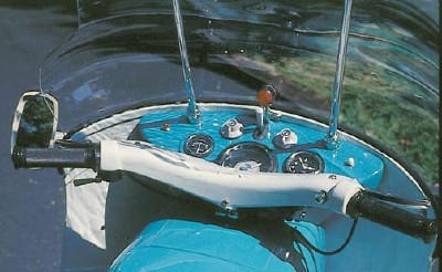

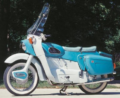

Few US imports of any derivative from the '60s appear to have had turn signals; the same in Britain, where it wasn't until the importation of the Honda C50, C92/95 & C72/77 that turn signals started to appear on mainstream bikes. From 1959, in the UK, we had a 'comfortable' machine called the Ariel Leader; a faired-in 250cc 2-stroke twin with luxuries such as a short, mechanical lever to adjust the headlight beam height, a clock, hard, permanent panniers and optional turn signals. The Leader had a sportier sibling -- the Arrow (and Arrow Super Sports) without turn signals; the Golden Arrow pictured below seems to have after-market bar-end winkers. Ariel eventually flopped in '65 due to the higher-quality, more powerful (and more desirable) small-displacement Japanese bikes being imported.

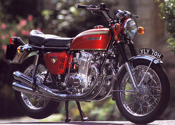

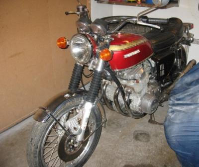

Here are pics of other original '69 CB750 "sandcasts":

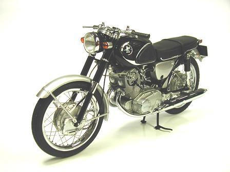

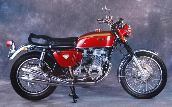

Hi,
Steve, is that one in the garage, yours ?

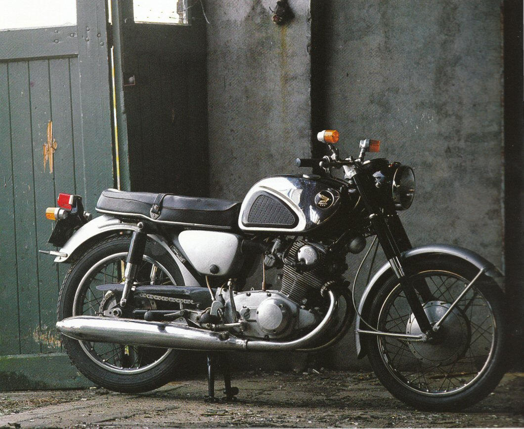

In Germany Honda used the old type round winkers, same style as the CB72 in this thread.
(both pictures are captured from the Pictorial history of Japanese motorcycles written by Cornelis van der Heuvel)

No, the CB750 isn't mine; I have just my old girl. It belongs to a fellow forum member in Norway -- it should be finished by now! (Any updates, Jan?).
Most* UK Hondas**, from '69 to circa '73 were fitted with the style of winker (and taillight, of the last two, á la final CB77s) depicted by the three 750s I posted.
*where fitted
**C50/70/90; CB125/175/250/350/360/450/500Four/550Four/750Four; CD175; CL250/350/360/450

Sorry Steve, not the sandcast, the 63 CB77 or the 62 German C92 is finnished, but I have got a 61 CB72 with no engine, and there is no paperwork for the bike either, so I have started to collect a race kit for it. Actually it started because I had my 5 speed close ratio gearbox. So if anyone have a 61 CB72 engine I am interrested. I have also got a 59 model C92, Japanese model with a rotary change gearbox. That means that from 4th gear, you go directly to first gear again! Dangerous, hehe.
