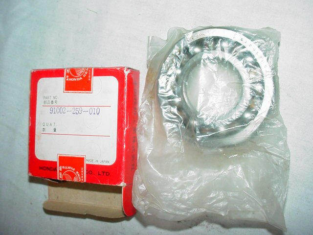

Hi LM,
According to my nr. 2 and nr.3 parts manual it doesn't exist, but the slip says 91002 259 000.
It only fits in very early crankcases, and it isn't a roller bearing either, it has "needles", but is a one piece bearing. The clip holds the parts together, and should be removed when installing the bearing.
I installed one of these bearings in my 1961 engine.
The other one is the one that fits the regular engine cases (the 91002 259 010).
Jensen
