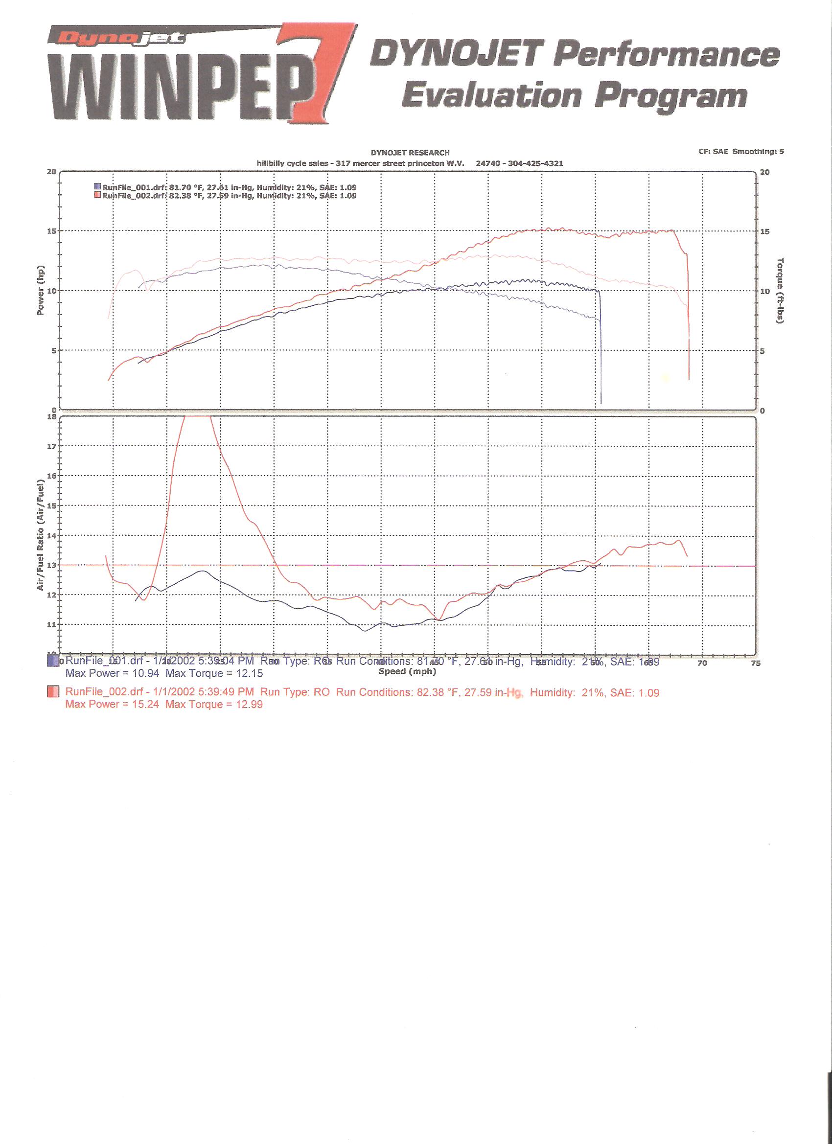

Another run today to test another (identical) carb I picked up on ebay.
Same jets and settings except needle at MID position instead of previous setting of one notch richer than mid.
Results:
Idle...............13.1-13.5
1/8................14.0-14.5
1/4................13.0-13.5
1/2................11.5-13.5
3/4................13.0-13.5
WOT..............12.0-13.5
Off to 1/8 throttle stumble was all but gone, and off/on throttle transitions at all openings were smooth.
I did locate a smaller main jet to try, but decided against it on this run.
Looks like the needle dropping also significantly leaned out the WOT ratio.
I guess it's not that surprising as about 1/4" of it still remains in the needle jet at WOT.
The acceleration improvement in high gear seemed noticeable.

Hi,
Nice curves, especially the full throttle curve. The mixture tends to lean out a bit in the higher regions, and is a little too rich in the middle regions, and maybe you need another chain or chains.
I would try to lower the needle one groove, and try a slightly bigger main jet.
The torque curve is nice, but is goinf down very quick, and that's because the power curve is hollow
Earlier I explained the "lean" peak in the lower regions, this is due to opening the throttle a little too quick. I think opening at 1/2 throttle was a little more gentle.
Do these figures differ a lot from the direct readings you get from your device ?
Jensen

Jensen,
The readings from the dyno are close to those observed from the meter.
If you look at the last table in the above post, the 1/2 throttle varied from 11.5 - 13.5,
and full throttle from 12.0 - 13.5 on the meter......pretty close to the dyno readings.
I was surprised that lowering the needle one notch resulted in a whole percentage point increase in the WOT A/F ratio.
As it is right now, the bike is pretty smooth and rideable, with the A/F in the 12.5 - 13.0 range at normal operating rpm's. It is only approaching lean at highest rpm's.
I may try one size richer main and one notch lower needle as you suggested.
I am now confidant the meter is accurate and its reaction time is quick.
It still shows an instantaneous lean peak between off and 1/8 throttle, but it's effect is not nearly as noticeable as it was before I lowered the needle.

Hi Brewsky,
Sometimes one notch is a too big step, I prefer going up and down with a third notch, just by adding rings under the cir clip. But make sure the rest is ok (air filter, ignition etc.) When seriously going in to the carb the rest should be immaculate, especially with a dream, which is very sensitive for needle hight and air filter issue's (as you now know).
You should definitely try a slightly bigger main jet, since leaning out with an air cooled engine in hot weather climbing a hill is something you don't want. Piston skirt failure and small end bearing issue's will reveal itself.
If I would have to work on this bike I should try a bigger main jet, to get the mixture around 12,5 from 7000 rpm and up. After having that fixed I would find a needle setting to accomplish a straight midrange mixture from 3000 to 7000 rpm around 13 or so. I would also experiment with the float hight to achieve that (steps of 0,5 mm to start with) to see what the influence is on the mixture.
Again, the wobbling on the curves are due to chain slack and / or a bad chain, this is costing much energy thus power. The dream is a 360 crank with a symmetric ignition sequence, so I expect a smooth curve.
