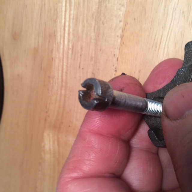

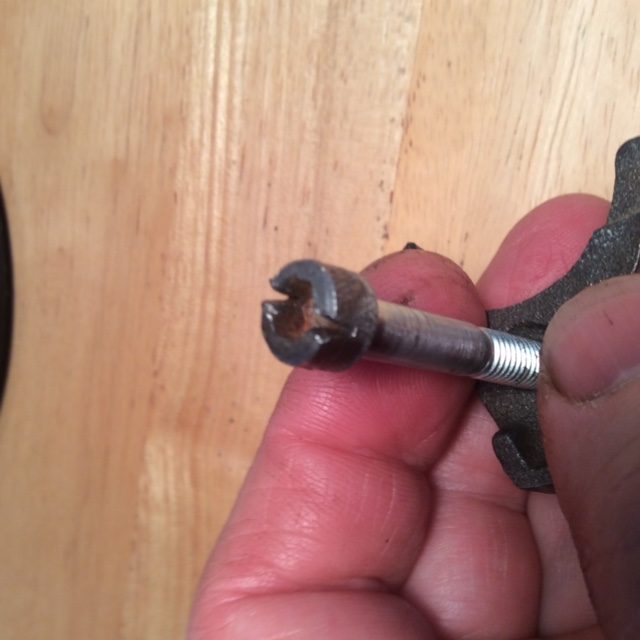

While cleaning parts that will eventually go back into my right crankcase cover, I decided that the clutch adjuster screw was looking a little beat up. I looked it up on CMS and found that instead of a knurled and slotted socket cap screw that I have, they have it as a plain bolt (part number 92000-06040). Is my cap screw an anomaly added by some previous owner? I kind of like it….
