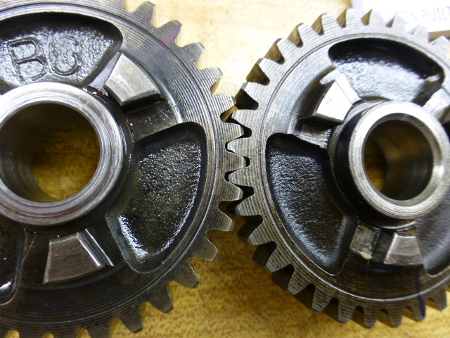

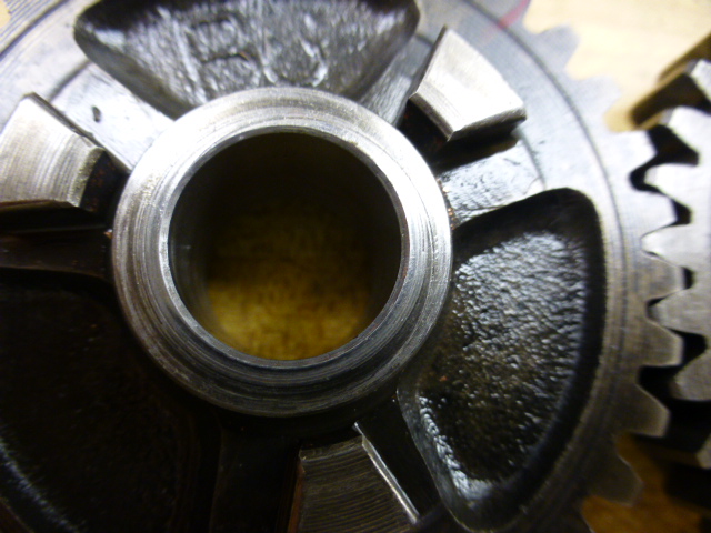

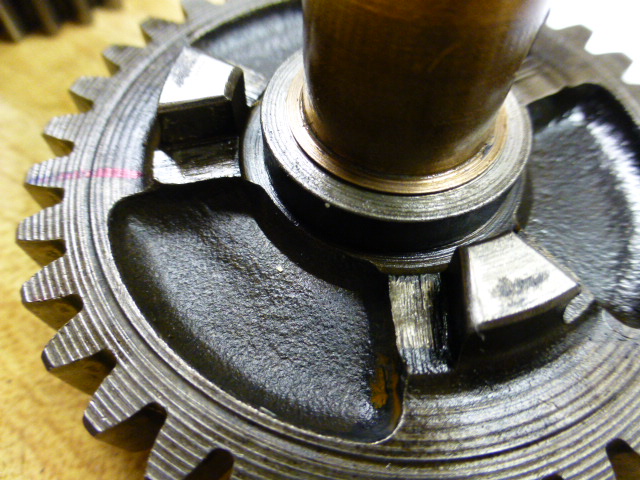

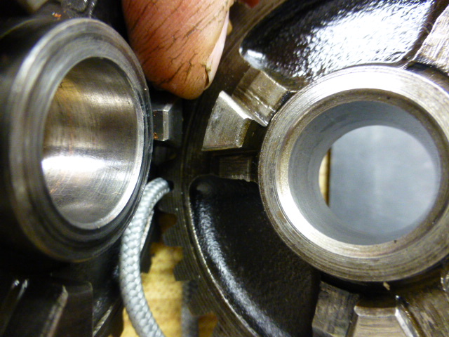

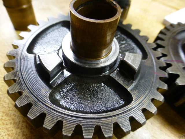

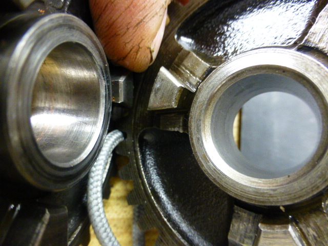

Did some more looking at my gears. Transmission in this bike are the last issue, shallow splines on the shafts. The first gear has almost no taper. When I replaced the bushing it was because the shoulder was so small, now looking at it, it's a match for the small taper on the gear. I have a gear from a slightly older transmission and it has more taper and a bushing that matches that. I think I'm going back with the original gear and original bushing which fits properly in the other regards. Guess I should have done that in the first place. With so little taper in the gear the aftermarket bushing must have been binding, or at least that's my guess.
original later issue worn in with narrow shoulder
earlier issue worn in wider shoulder
original on left, earlier issue on right
Original gear
Original gear
Original gear on the left
