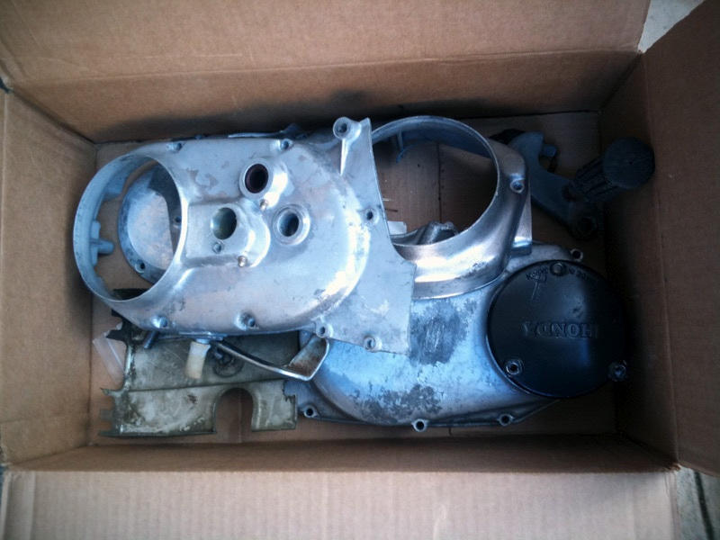

Post by Spargett » Thu Jan 28, 2010 4:34 pm
FastFred hooked me up with a box of parts I've been dying to get ahold of for a great price. Been doing alot of stripping, painting, and polishing to get them back to their original condition.
Can't wait to replace previous owner's CL kickstart with the proper CB!
