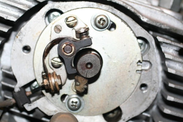

I am pretty sure that I understand exactly what you are saying to do and I just tried it. I know that what you are saying is correct but unless I am totally misunderstanding, it is physically impossible on my engine. The attached photo shows the points cam at top dead center...slightly past the F mark. At this position, the points "lever", for lack of a better word, is just entering the range of the shaft that would be causing it to open. Therefore, it has already been closed for quite a while at this point. In order to catch it approaching its closing position, which would send the spark as it reaches F, it would have to rotate approximately 90 degrees to a position that just follows the apex of the shaft as it rotates clockwise. It currently precedes the apex. This picture is an old one that still shows the points plate rotated as far clockwise as it will go but I have also tried it in several other positions, including centered as you instructed and fully rotated into the new channels that I opened. A suggestion that I just read in response to my posting under "Motors" indicates that another 305 owner had success by filing down the "follower" (lever?) but I dont see that improving this situation either. Is it possible that this is just the completely wrong points plate for this bike and it is therefore oriented so far off that it wont work? The 2nd picture shows a points plate currently listed on ebay for a 305 that is COMPLETELY different than mine. I cant tell for sure how it mounts but is this a better part for my engine? Another clue to support this theory is that this photo appears to show a metal follower lever and my cam has slight scratches that I dont think would have been caused by the bakelite type lever on the current points. None of this is really making any sense at this point but what I do know is that its still not running correctly. Sometimes the simplest solution is all thats left.
Post by LOUD MOUSE » Tue Nov 06, 2007 5:49 am

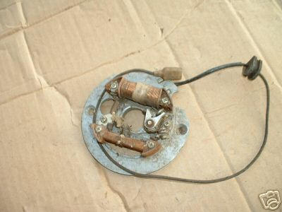

We may be near the answer. The coil fires when the points OPEN not as they CLOSE. So please try as I last suggested. Move plate to center. Put continuity lamp to wire on points. Turn key on. Rotate rotor to "F" and then open/close the points so the light Comes On at "F" and tighten points to plate. I don't know what that other points plate is for but for sure not any 305 I've ever seen. Your plate is correct for a DREAM engine. ....................lm
Bob Dale wrote:I am pretty sure that I understand exactly what you are saying to do and I just tried it. I know that what you are saying is correct but unless I am totally misunderstanding, it is physically impossible on my engine. The attached photo shows the points cam at top dead center...slightly past the F mark. At this position, the points "lever", for lack of a better word, is just entering the range of the shaft that would be causing it to open. Therefore, it has already been closed for quite a while at this point. In order to catch it approaching its closing position, which would send the spark as it reaches F, it would have to rotate approximately 90 degrees to a position that just follows the apex of the shaft as it rotates clockwise. It currently precedes the apex. This picture is an old one that still shows the points plate rotated as far clockwise as it will go but I have also tried it in several other positions, including centered as you instructed and fully rotated into the new channels that I opened. A suggestion that I just read in response to my posting under "Motors" indicates that another 305 owner had success by filing down the "follower" (lever?) but I dont see that improving this situation either. Is it possible that this is just the completely wrong points plate for this bike and it is therefore oriented so far off that it wont work? The 2nd picture shows a points plate currently listed on ebay for a 305 that is COMPLETELY different than mine. I cant tell for sure how it mounts but is this a better part for my engine? Another clue to support this theory is that this photo appears to show a metal follower lever and my cam has slight scratches that I dont think would have been caused by the bakelite type lever on the current points. None of this is really making any sense at this point but what I do know is that its still not running correctly. Sometimes the simplest solution is all thats left.

Now it makes much more sense. I incorrectly thought that the spark fired when the points closed to complete the circuit. Firing at the open position obviously negates everything that I said above. I will try it again tonight.
Bob Dale
Posts: 66
Joined: Tue Sep 11, 2007 9:27 am
Location: Houston
Post by Bob Dale » Tue Nov 06, 2007 10:24 am
Also, I must not be using my meter correctly since I was checking for completion of the circuit, not opening. My test light is burnt out so I have been using a voltage/continuity meter but obviously not connecting it to the right places. Where should each lead be attached...one side to the points and the other to?
Post by LOUD MOUSE » Tue Nov 06, 2007 11:42 am
One side to the wire at the points and the other to anywhere on the engine cases. .................lm
