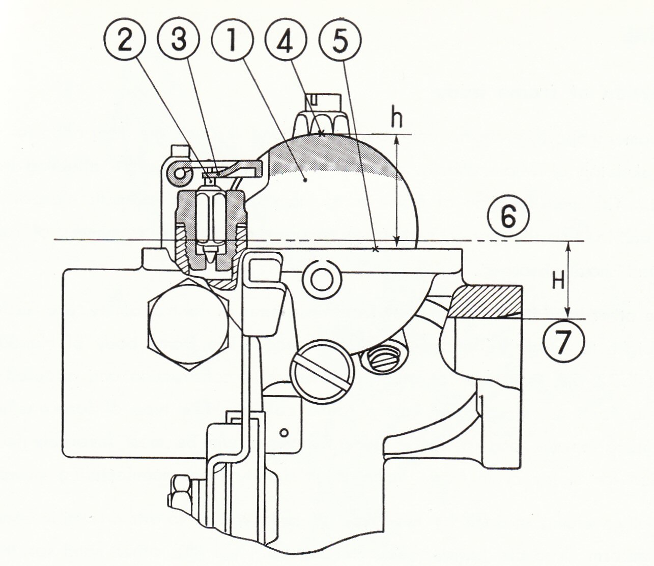

Thanks for the reply, Jensen.
I appears to me that the most important measurement is "H" (distance from 6 to 7) in the last pic you attached. Do you have any published values for this distance for PW22 carbs? This would be the actual distance from the fuel level in the bowl to the bottom of the carb bore.
When I set my 750 carbs, I use clear tubing from the bowl drains running up beside the carbs as a check for equal bowl fuel levels. This method could also be used to measure the actual distance "H", if you knew what value "H" is supposed to be.
I can't imagine a value for 'H' being published anywhere. It simply refers the fuel level in the bowl, which is indeed critical. I don't think 'H' was ever intended to be measured directly, and that's why it must be arrived at by using the rather ambiguous float height measurement.
If Honda had provided a few inches of clear tubing and a reference mark on the outside of the carb bowl we wouldn't be having this discussion! But even had we been so lucky as to have that, there would still be variables in the mix: jets, bleed holes, needle wear, temperatures,....
'H' is attainable, but in most cases will result in proper fuel metering only by accident, divine intervention or black magic.
