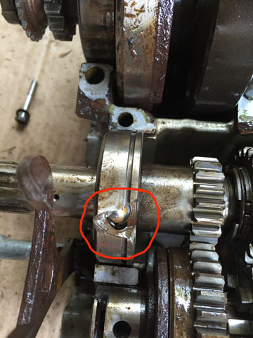

I currently have the cases split and all is looking good with the exception of a broken transmission bearing which I need to source if anybody knows where to find them...will post pic soon.

Broken Transmission Bearing...
Post by LOUD MOUSE » Tue Jul 07, 2015 4:53 pm
What else got KILLED?. ...........lm
rideordie wrote:Broken Transmission Bearing...
rideordie
Posts: 95
Joined: Tue Mar 03, 2015 2:35 pm
Location: Orlando, FL
Post by rideordie » Wed Jul 08, 2015 8:48 am
LOUD MOUSE wrote:What else got KILLED?. ...........lm
With the exception of some difficult case screws and the frozen pistons that was about it. As far as a visual inspection goes, everything looked surprisingly good. Don't think the engine was ever opened up prior to my beat-down haha. Will need to check tolerances/spec's to officially confirm that but as of right now I'm quite happy with everything :)
