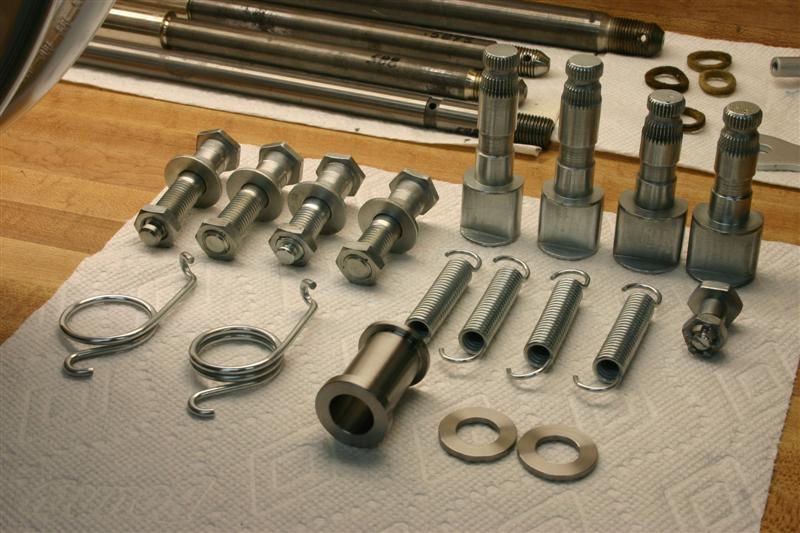

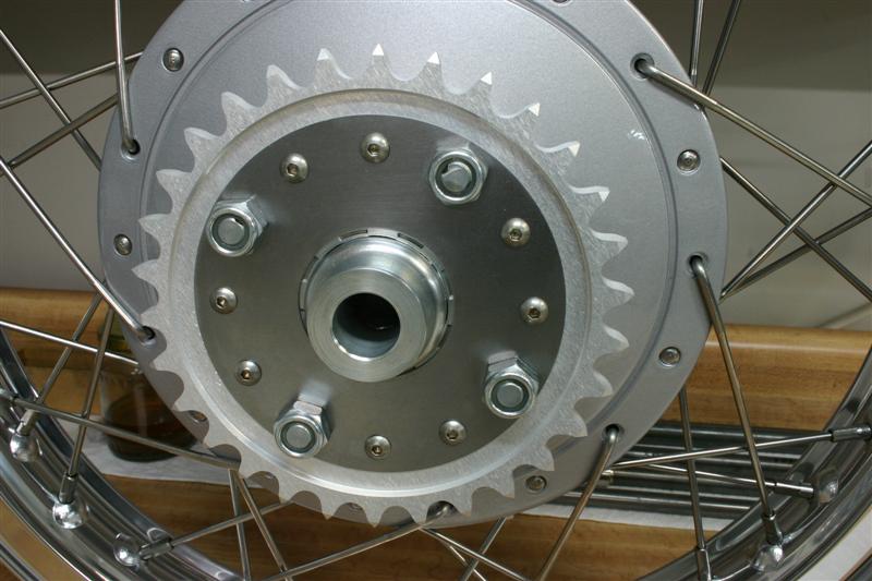

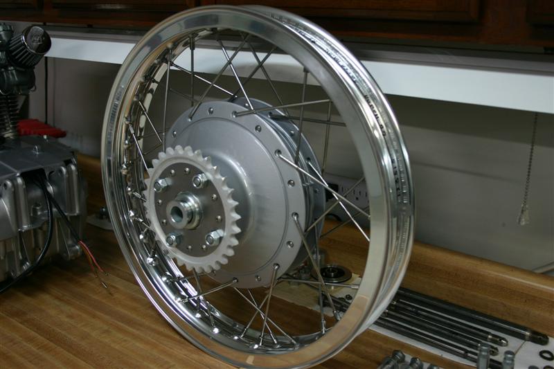

I did some plating yesterday [brake parts]; also made a front wheel collar and some swing arm pivot bolt washers, S/S; got the sprocket on, but the cover plate was warped, so I had to add some button screws to it.

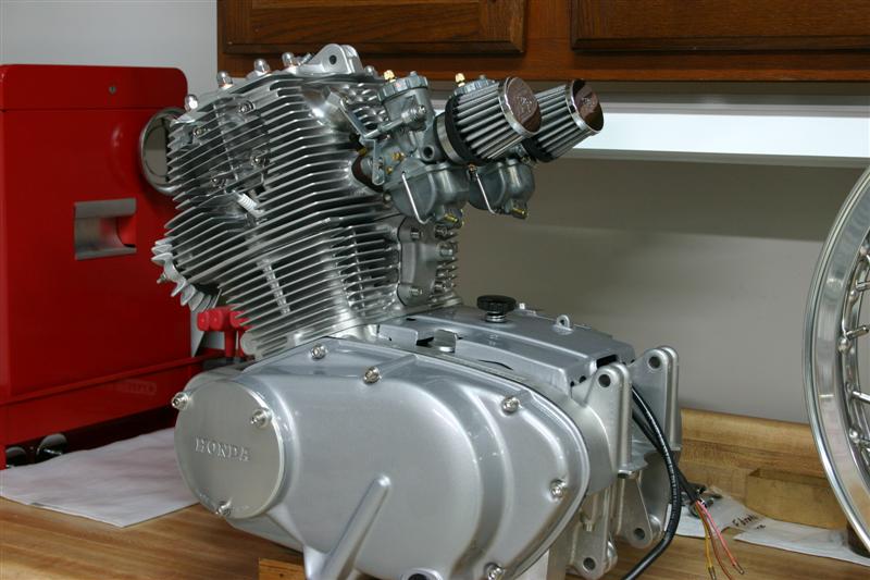

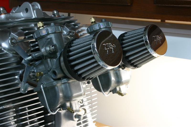

My K&N filters arrived today - ordered them direct from mfr., p/n RC 0790. The tech at K&N said they will flow 100cfm each. I will oil them when ready to put in service.

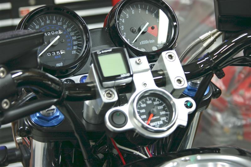

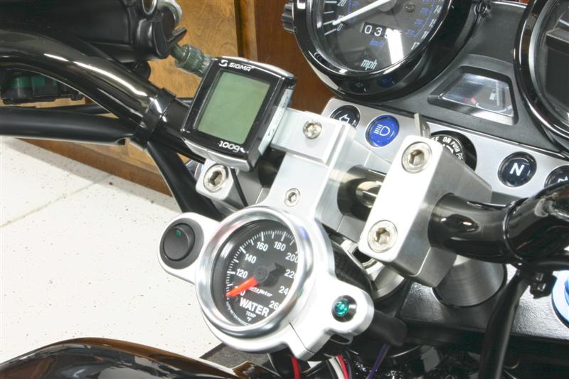

I installed a Sigma bicycle speedometer to my Kaw, and now they make them wireless. They have odo, trip odo, time, speed, avg speed, max speed. I plan to use one for this project. I designed and machined the bracket for the AutoMeter temp gage, as well - I really like their products. I plan to mount the AutoMeter tach centered above the headlight, and the Sigma offset, closer to bars.
