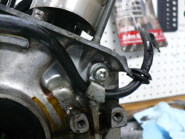

Remove the starter motor cable clamp and pull the stater cable.
Post by e3steve » Tue Mar 01, 2011 7:59 am
Great tutorial for first-timers, HT; very nice detail.
I started breaking down my '64 motor, starts halfway down here, in the Feb 20 post, albeit less detailed.
I took a slightly different approach, pulling everything I could off the lump before dropping it out; I found handling it a lot easier with much of the weight already removed (back problems that I don't wish to aggravate), plus the bloody thing doesn't wriggle around as much, like a wounded piglet, possessing a life of its own on the bench! Tight screws and pulling the rotor are less dramatic with the motor still in the bike.
Different strokes & alternative approaches......
Hoosier Tom
Posts: 817
Location: Logansport, IN
Post by Hoosier Tom » Tue Mar 01, 2011 2:17 pm
Good point Steve. It's a lot easier using an impact driver on the case covers with the motor still attached to the bike. Nothing like chasing the motor around the workbench every time you whack it. I hear you on the back problems- just glad the thing isn't a damn 750-4, those things weigh close to 200lbs!
One of my aims was to photo doc for first timers and I got aggravated at myself for tearing down the top without photos. Maybe I can find redemption on the rebuild postings.
Thanks for stopping by- HT
