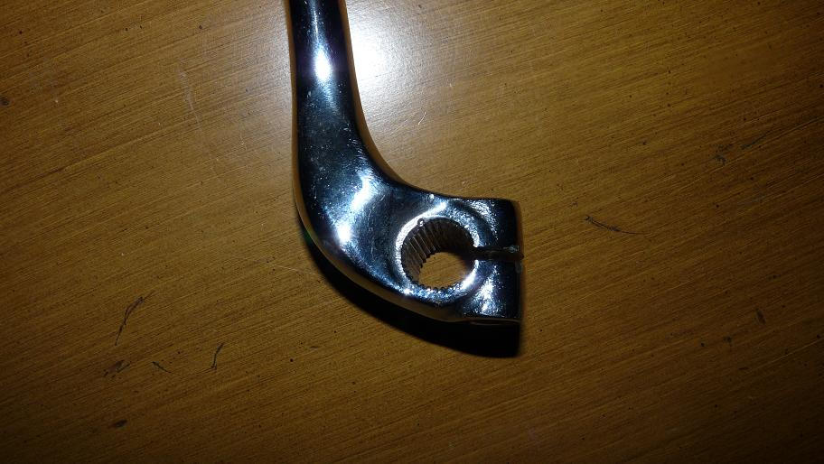

Post by LOUD MOUSE » Sun May 23, 2010 1:08 pm
HONDA in their wisdom indexed all the KS parts so the lever will be at a position which has it clearing your arch and gives the best kick angle.
If ya "Do It My Way" ya will have at least one problem with the lever position/angle.
Here is a pic of the index punch location. . ..............lm

Post by Wilf » Sun May 23, 2010 1:18 pm
Thanks for the pic, LM. I should be able to fix the position accurately from that.
