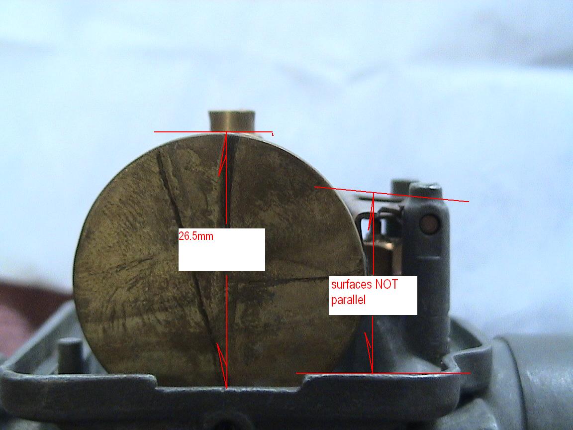

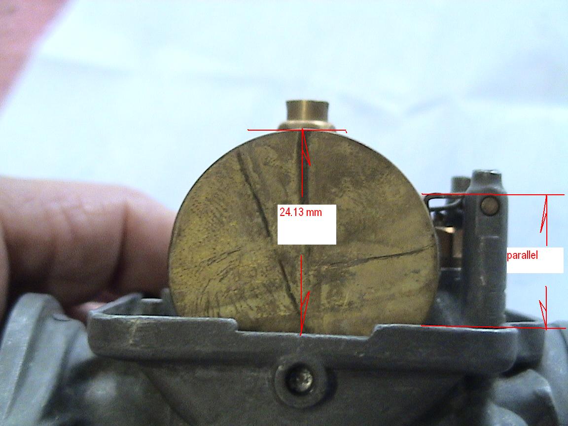

Jensen,
Here are my measurements for both your parallel arm method and the line of sight method (at least as I understand them)
Note the measurements are taken from the carb body cutout and not the gasket surface.
Your parallel arm method, if measured from the gasket surface, gives very close to 26.5mm.
Closer measurement reveals there is a 2.2mm difference between the gasket surface and body cutout reference points.
Both are with float tang touching but not depressing the float valve.

I have bent the tab and tried it both ways, and it results in different float heights:
one .......26.5mm from cutout notch...(float lines up with jet holder)
and the other......26.5mm from the gasket surface.... (float below the jet holder, but float arm parallel with carb body)
There is a 2.2mm difference in the measurement starting point (cutout notch vs gasket surface) so there has to be the same difference in the float heights if you use the same spec distance for the measurement. (26.5mm for PW22 carbs)
The notch in the PW22 carb body is there as when Yasshi installed the float and used the HONDA tool all carbs were correct and would work as designed.
Ya can bend the FLOAT Things to what if any angle ya like (by now many have been changed from issue) and as long as ya have the correct MM and tang correct the dern things WILL WORK.

brewsky wrote:Jensen,

Brewski,
From what I have seen over the years, the floats could be out by 3-5mm and owners wouldn't notice it.
Both you and Jensen are searching for perfection and we know how obsessive and all consuming that can be.
What I'd suggest/request is that you set the floats say 3mm low (fuel level high) and test your bike's Lambda and performance.
Then raise the floats/drop fuel level 1mm at a time and repeat and tell us what the effect is on A:F and what differences you can measure.
The hypothesis is that the measured performance difference will be negligible but the A:F will show changes (not serious though) and that the rider will detect changes in rideability.
