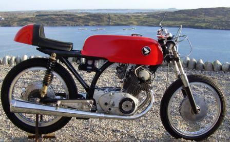

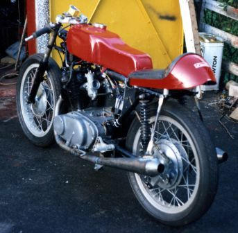

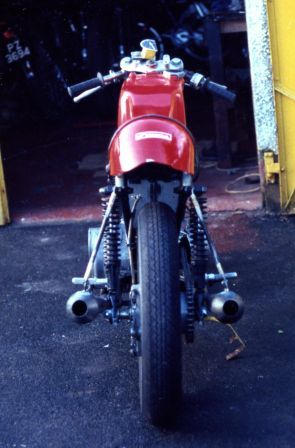

The tank came with an engine I bought from England. I think it might be a Dunstall which was a complete fibreglass tank seat unit. I have seen these on a CB77 / 72 and on a Suzuki T20. The seat that was attached to it, can be seen in the photo above on the bike closest to the wall. I have posted another photo of the tank before I cut the bottom lip of I’ve got five of these bikes and some spares so im taking a mould of the tank and hope to make a couple more for the other bikes.
It would be great if anyone could post any photos of them racing a CB77 / 72 or the yoshimura. Thanks again all the best. Regards PT.

Is that an oil try under your engine. The bike looks good in the production trim.
Keep the photos coming there is always something different, Id love to see what you’re doing as well Bill. All the best.
