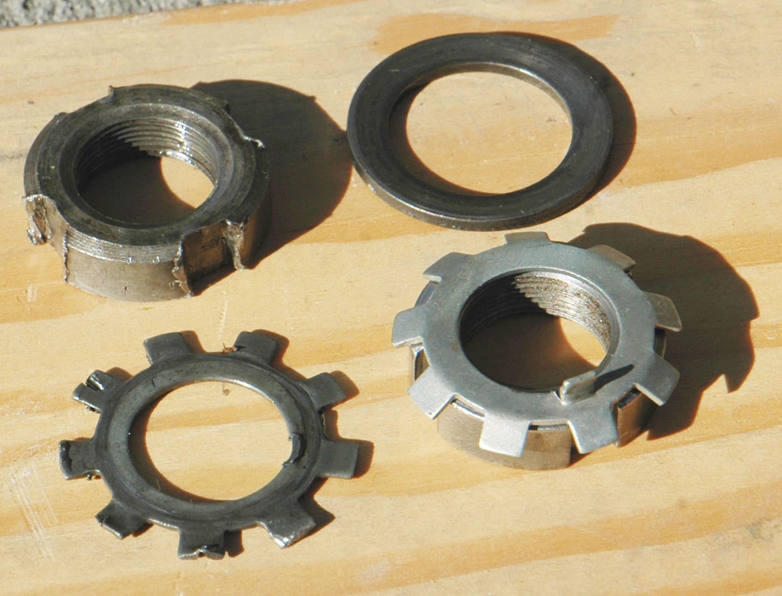

So, I've attached a photo of the new and old bits. Having only seen the old flattened washer (bottom left) I was not expecting the cone shaped replacement I got in the mail. Nor the single tab on the inside.
Looking at the new parts, it made sense that the bevel of the nut must match the shape of the washer. Just to make sure I am understanding correctly though, I have mocked up the fitment in the bottom right corner of the photo. The new washer is sitting on the bevel of the new 20mm nut.
And, LM I think I read on another thread that you advise putting the nut back on as tight as you can get it by banging in the reverse direction with the chisel. Correct? Any additional advice - I'd hate to break or damage something.
Oh, and with the non-tabbed washer in the photo (top right) was trying to show that there is some concavity to the part. Were these flat when new or did they come with a slightly dished shape to fit the cone of the tabbed washer?
Funny how so many questions can arise from just a few little bits. Thanks for all the comments gentlemen.

Washer first, lock washer then nut. ................lm
