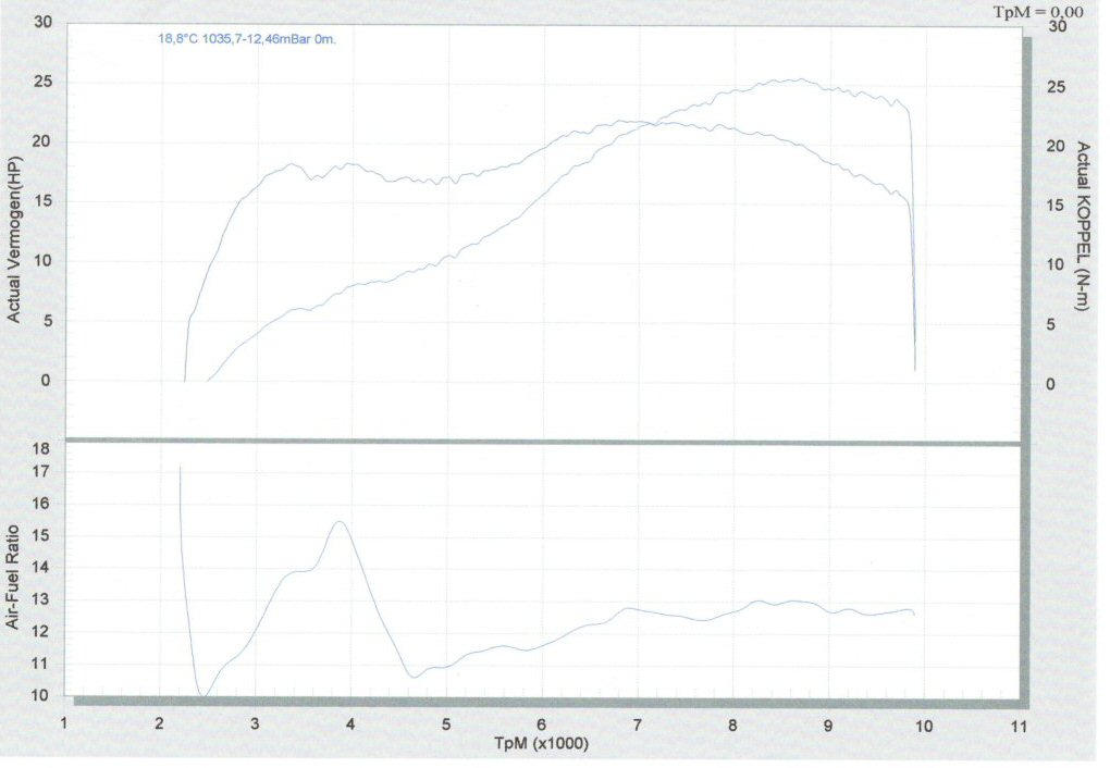

Hi,
As promised, a run from 20/09/2008 of my C78 '64.
Engine rebuild 30.000 km back, new crank, pistons (0.5mm over), new head and perfect gearbox.
Carb rebuild complete, everything important replaced by original Honda parts, including needle.
Paper oil filter conversion, no spinner filter (read my other threads about it if interested).
The head is flowed a bit (intake channels) to make them exactly the same, internals are new.
It has early cams and has the early two piece stainless steel mufflers.
Full synthetic oil (10W50) super-bike oil does the job inside.
Engine revs to 10.000 rpm, and feels strong all the way. When you open it up quick, you will get the massive mountain between 2500 and 4500 rpm. In the midrange I have it a little rich (needle) for better acceleration. It stops pulling at 7500, after that it will take a long time to hit 10.000 rpm, it sure doesn't feel as rev happy than the CB72 in this area.
In it's days a c77 was a sport bike, now it's not anymore compared to modern machines.
This typical engine runs good and I can drive it on the highway (120 km/hr). It's not that I wanted a high performance bike, but to get as close to perfection as possible.
I never saw other dyno runs from a C77, other then mine, so it's a bit of experimenting
Before you start comparing, please notice that the torque is koppel in dutch and we use newton meter.

Thanks for posting your graph, and it appears you have a very strong engine compared to stock advertised numbers.
I cannot seem to find any other dyno results posted for the single carb 305 engines either.
Now I am convinced the tech did not max out the RPM on my run and I need to find a supplier of jets for Keihn carbs.

Hi,
I knew these existed, but I never used it.
Well, 20 USD for a run is a bargain, but only if it's useful.
No, that's why I asked if he pulled it into the high regions, the torque curve should go down around 6000 a 7000 rpm, like mine does, that's normal.
I think he has a mechanical rev counter as well, ask him to use that one to calibrate the dyno results .
Maybe the tech wasn't sure (scarred) how far he could pull it.
jensen

very nice to see your efforts. cant wait to see some legit curves. never worry about power numbers, its all about those curves!
interesting little bit about the carbs, now i understand the lean peaks down low.
perhaps this is taboo with these 305's but has anyone expirimented with advancing the base timing for power gains? apples and oranges here, but i was able to add almost 9* to my car with out detonation before it was turbo. yeilded almost a 20% gain on others dynos with similar setups.
