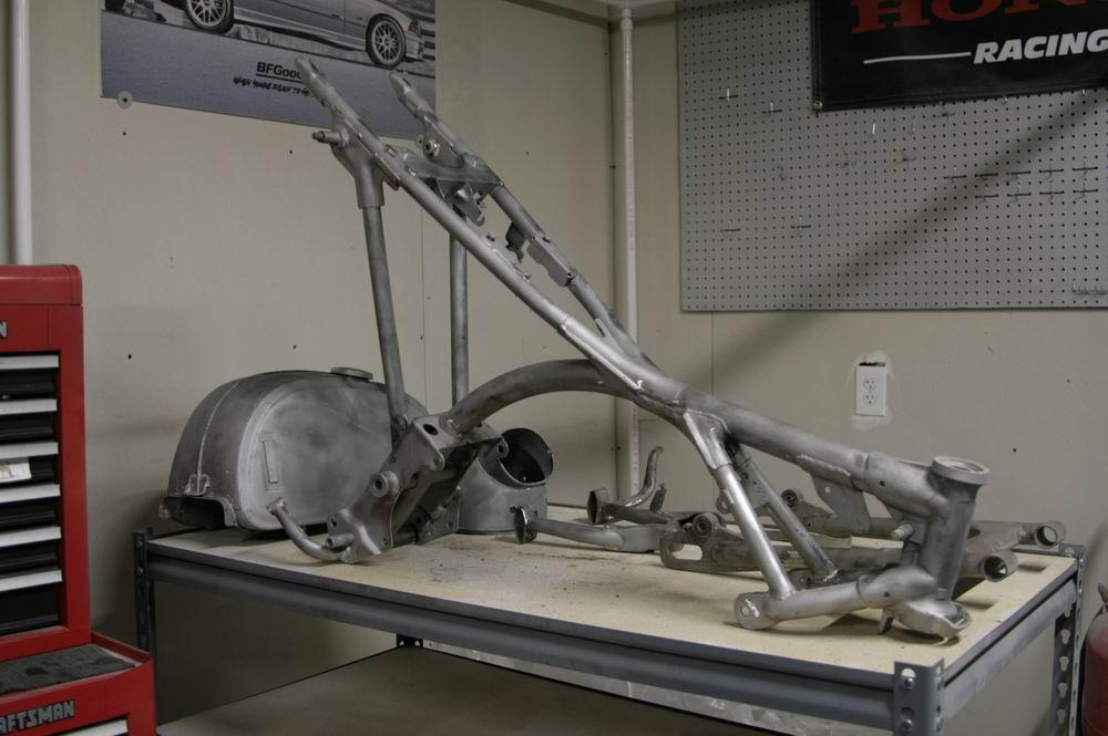

progress report:
The chassis is 95% disassembled. The motor is still in the frame waiting on head pipes from a dream. I'm hoping they fit with the Dunstall mufflers with a little trimming. Then I will take apart the motor and inspect it. At the very least, I plan on a .50mm over bore, new piston kit, new gaskets and new oil seals. One question - can I install thinner copper head and base gaskets to boost the compression ratio?
But first I will set up the rolling chassis. So, I plan on stripping the frame, swingarm, centerstand, lower triple, headlight case and a couple brackets before dropping them to the local powdercoater. Then I will clean up and blast the nuts, bolts, brackets etc before droppping those for zinc plating. I will polish the aluminum parts up myself.

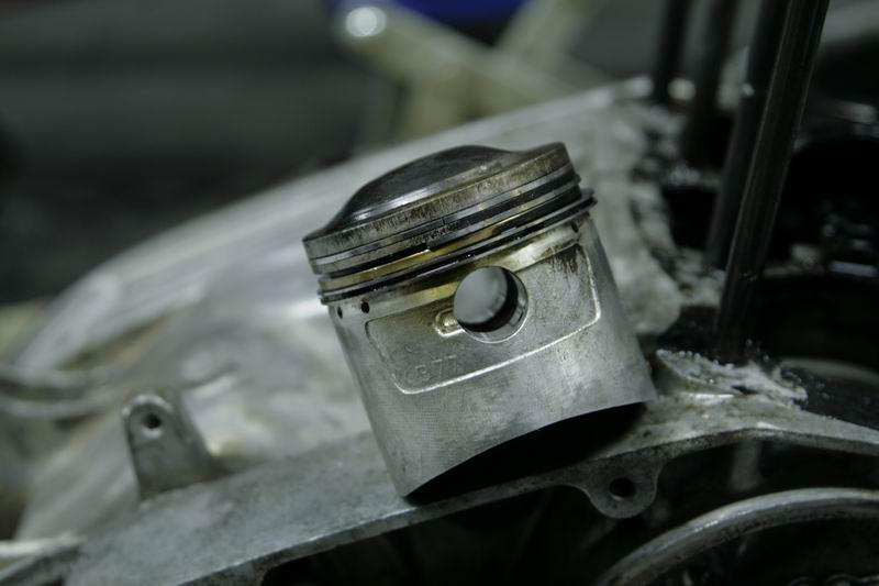

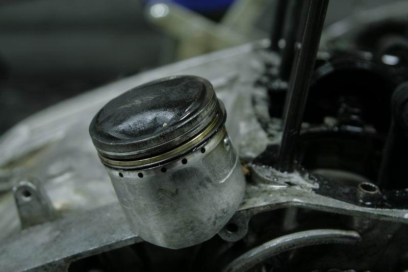

Took off the head, cylinders and pistons. Now, I see why it didn't have compression. On both pistons, the top two rings were pinched in the grooves and didn't provide a good seal. The cylinders had light scoring. I'm guessing since it sat for about 7 years, the moisture and rust locked it up. The next startup, the pistons and rings were probably damaged from the rust lockup after being forced to move.

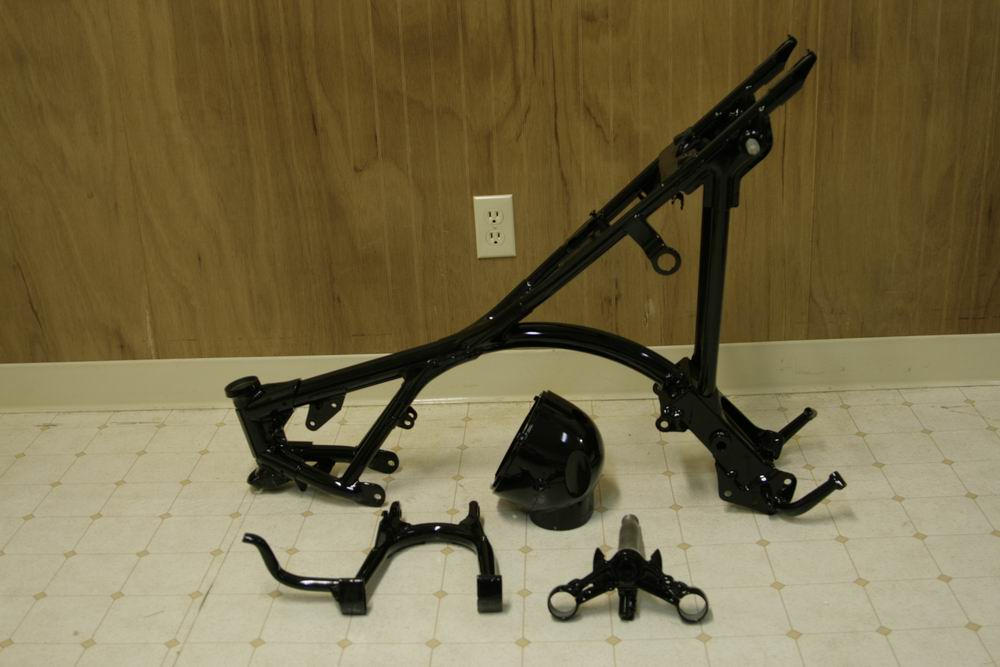

12/12: The powdercoating is done! I powdercoated the frame, swingarm, center stand, headlight shell, bottom triple clamp and the tank bracket. Looks like a great start to a cool project!

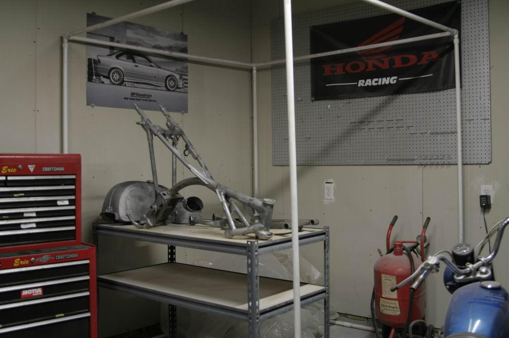

12/01: Here is a shot of my sandblasting/paint booth. I just tape up some plastic and its all set. I use a 40 lb pressurized blaster.
